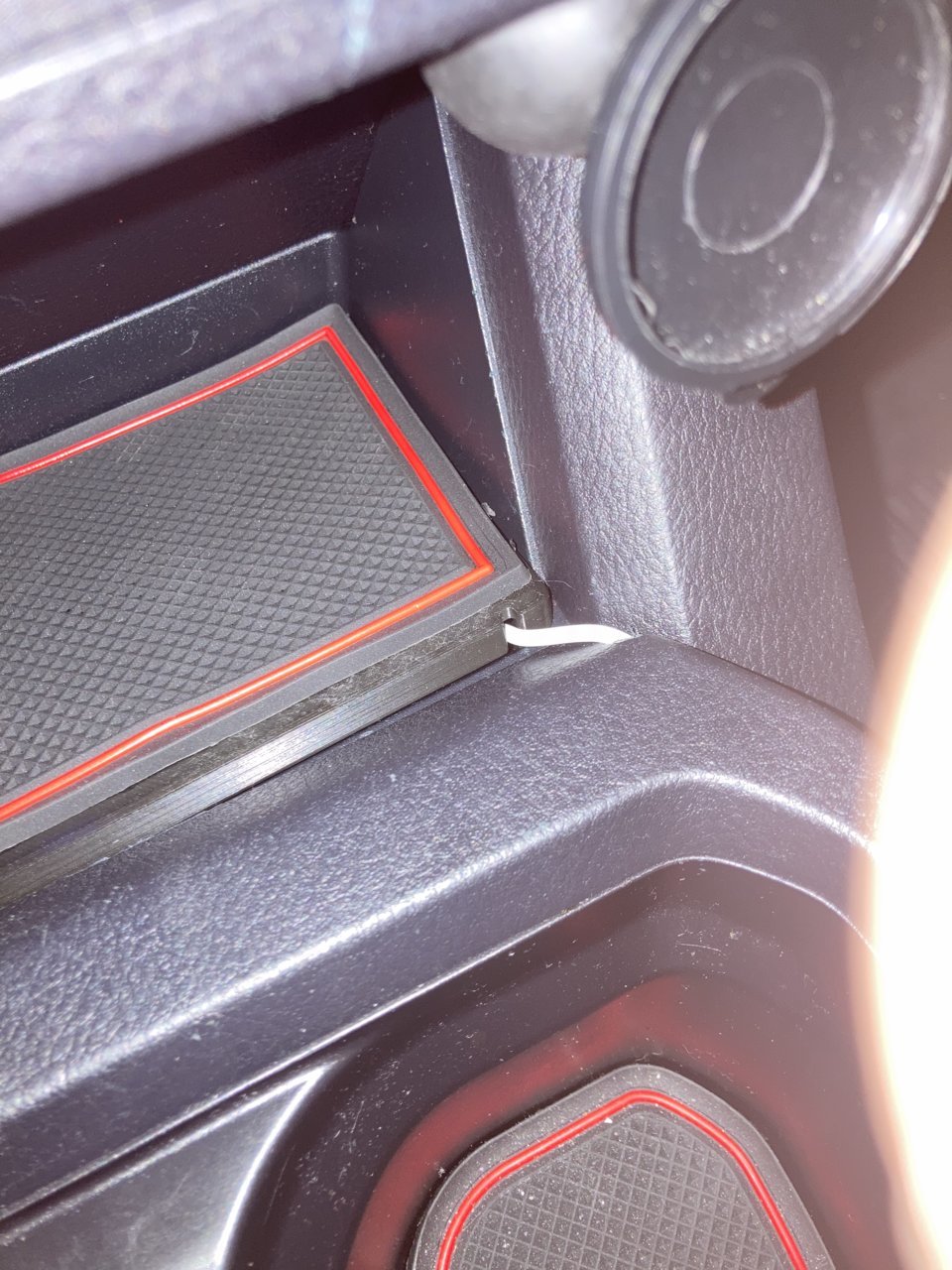

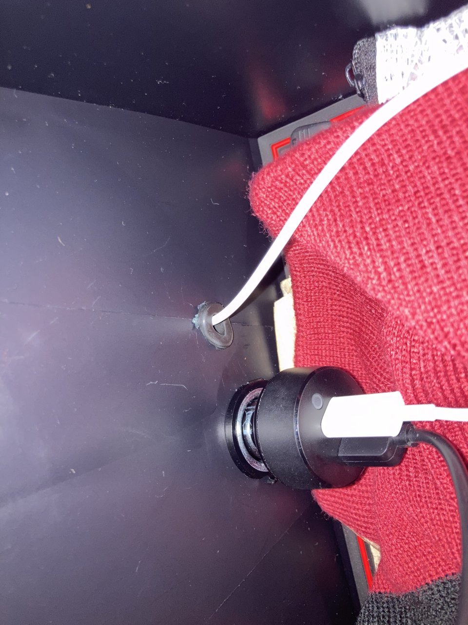

    Ran the MagSafe cord under the center console and out into the storage cubby. I think it worked out well. I Dremel’d a small notch at the front, and drilled a 1/2” hole for the cable next to the cigarette lighter plug. I installed a 5/8 OD gasket to protect the cord and keep the plug from falling inside.
