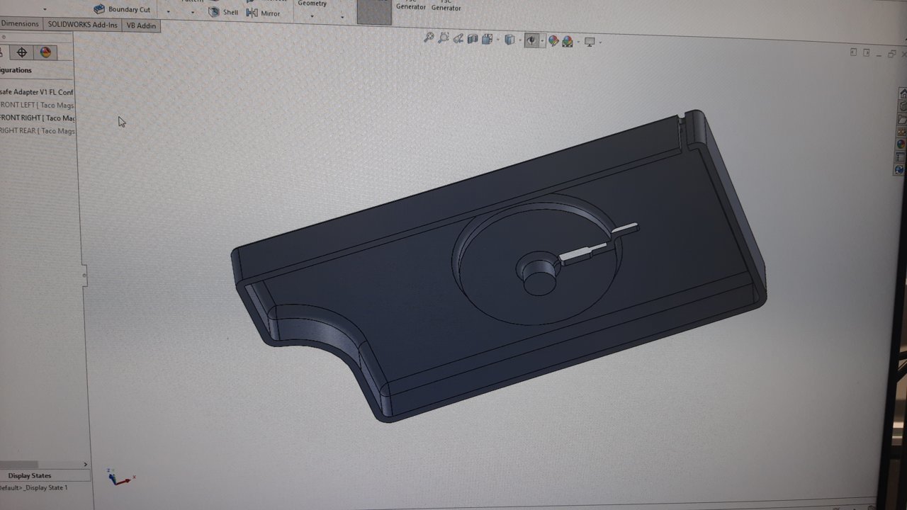

    Well, I thinned the walls to .125" and freed up a bunch of room on the underside.
    With the thinned out walls, I am uncomfortable putting multiple cable egress holes in the design as each one weakens the design.
    So I made 3 different files.
    Taco Magsafe Adapter V1 FR has the notch in the front right corner.
    Taco Magsafe Adapter V1 FL has the notch in the front left corner.
    Taco Magsafe Adapter V1 RR has the notch in the right rear corner.

    I trust that you folks on here will be able to print out a piece for fitment much faster than I can. Just let me know what changes need to be made to it for it to fit perfectly.
    I can't upload .stl files to this post (Administrators can you help with this?)
    So I will upload the SolidWorks files to this post and send the .stl files to folks who PM their email address.
    Happy Printing!

    MGM 2021 Tacoma TRD OR
    I think the best options for the cable exit could be, front right corner, because the power outlet is in the right top hand side of the qi charger. Left or right side, to maybe make an opening in the qi space wall to pull the wire inside and under the shift knob cover to plug it inside the center console USB plug. And the rear, either left or right. If someone wants to wire it somewhere else under there.
    The front left opening wouldn’t have a near by connection to use.
