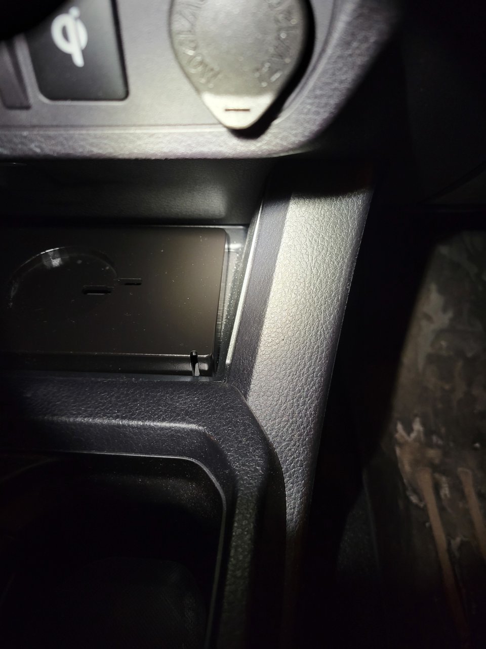

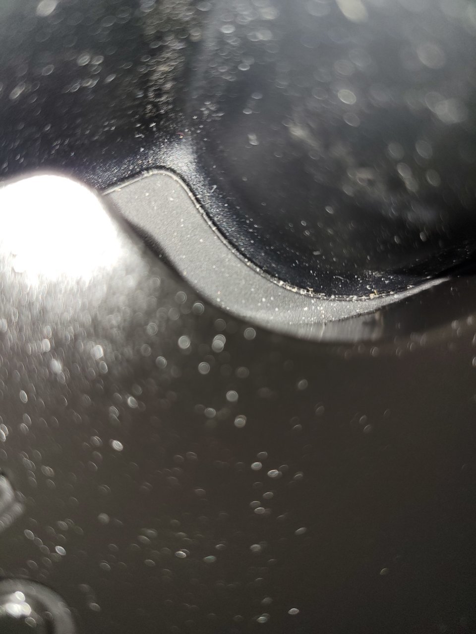

    It is uneven. It looks like the right side of the cubby is not square and the radius on the left is a bit short.
    Here is the list of suggested changes:
    1. Grow the back by 0.125"
    2. Slant the right side out in the back by 0.125"
    3. Bring up the radius by 0.250"
    4. Add a radius to the bottom of the walls to better match the outer perimeter of the cubby.
    Here is a paint CAD version of the changes.

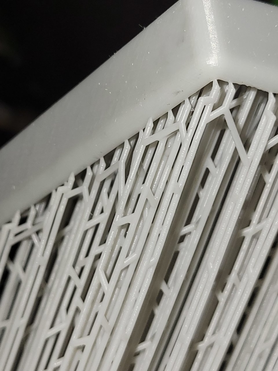

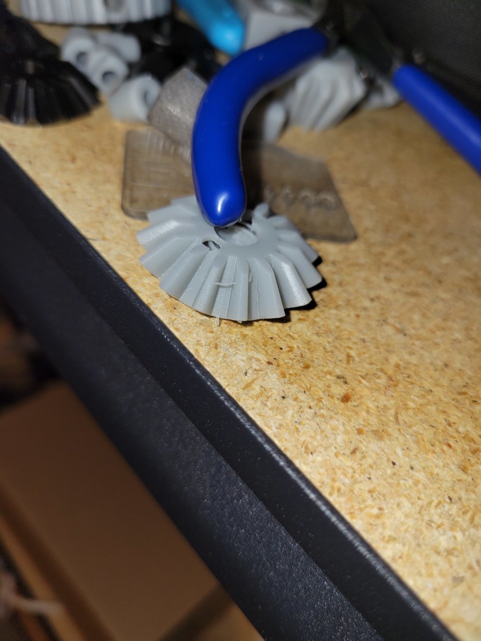

  18. Nov 2, 2022 at 7:48 PM
    #118
    Trail Limo
    Trail Limo Well-Known Member
    Aug 7, 2018
    #262048
    805
    There is a bit of a texture, but the resolution is 50um, so the layers are tiny.
    Resin results in a single solid part. Strength is equal in all axes.
    Post processing consists of cleaning in isopropyl alcohol, drying, then exposing to UV light. The UV light cures the resin and gives it rigidity and strength.
    Here are some images of parts to try and show the layer lines. That blue handle is about 3/8" in diameter for scale.
