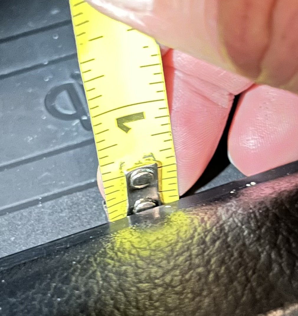

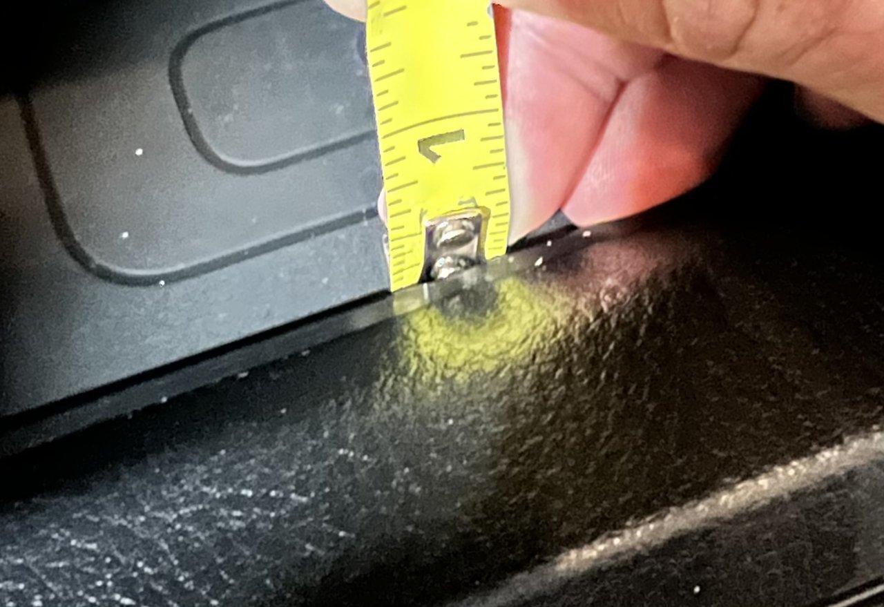

  • Nov 5, 2022 at 4:49 PM
    #154
    In2Ndo
    In2Ndo [OP] Well-Known Member
    May 22, 2010
    #37630
    366
    California
    MGM 2021 Tacoma TRD OR
    63BCBACF-5BF3-4A06-A0F6-6824AEB6CF30.jpg 2D140F7F-3B57-414C-95F5-C75833BBB739.jpg
    K. This would be the dept from the black edge in the front of the cubby.
  • Nov 5, 2022 at 6:58 PM
    #155
    Hercanstein
    Hercanstein Well-Known Member
    Jan 2, 2020
    #314990
    1,083
    Bryan
    State of Jefferson
    1999 2.7 SR5 4x4 5MT XC, 2020 3.5 TRD Sport 4x4 6MT AC
    ('99) Offset Aluminium Wheels, 31" BFG All-Terrains, Bushwacker Fender Flares, Window and Hood Wind Deflectors ('20) Stock
    Boy, that's not very tall. Less than .25"?
  • Nov 5, 2022 at 7:02 PM
    #156
    In2Ndo
    May 22, 2010
    #37630
    366
    California
    Yeah, I have no idea of what a 3D printed piece can handle. Just running it by you. To see what you think. Maybe just slanting it just a little. Or leave it as is. Without the center pole the difference in hight shouldn’t be as obvious. Specially if painted black to match the cubby.
  • Nov 5, 2022 at 7:09 PM
    #157
    Hercanstein
    Jan 2, 2020
    #314990
    1,083
    Bryan
    State of Jefferson
    Yeah I think beveling the front edge will look nice.
    In2Ndo[QUOTED][OP] likes this.
