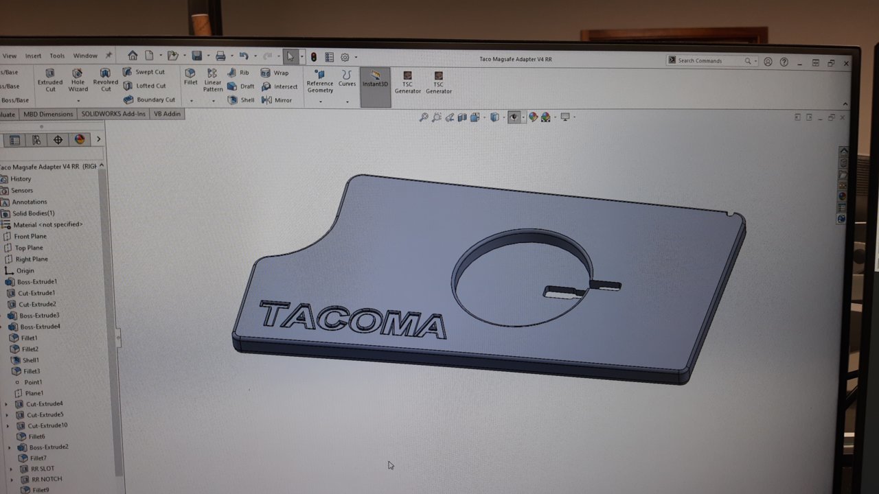

    Here is V4. I didn't like the beveled front edge. It is also .375" high. Also brought radiused corner .125 closer.

    Sent you and Trail Limo the V3 and V4 .stl files in email.
    I think we are almost there!

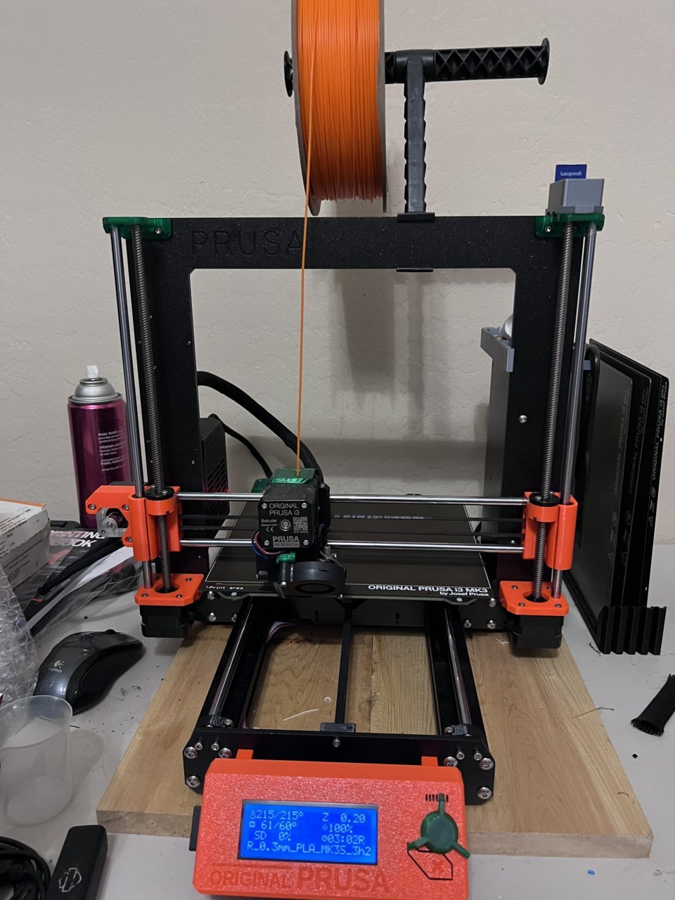

    Just started it. Should be done in about 3 hours, and I’ll be up for the eclipse, so I’ll post pictures up by then.
    Printing it in PLA at .30mm layer height, so it’s quality won’t be awesome, but it will get the fit test done for sure, and cost less than resin.

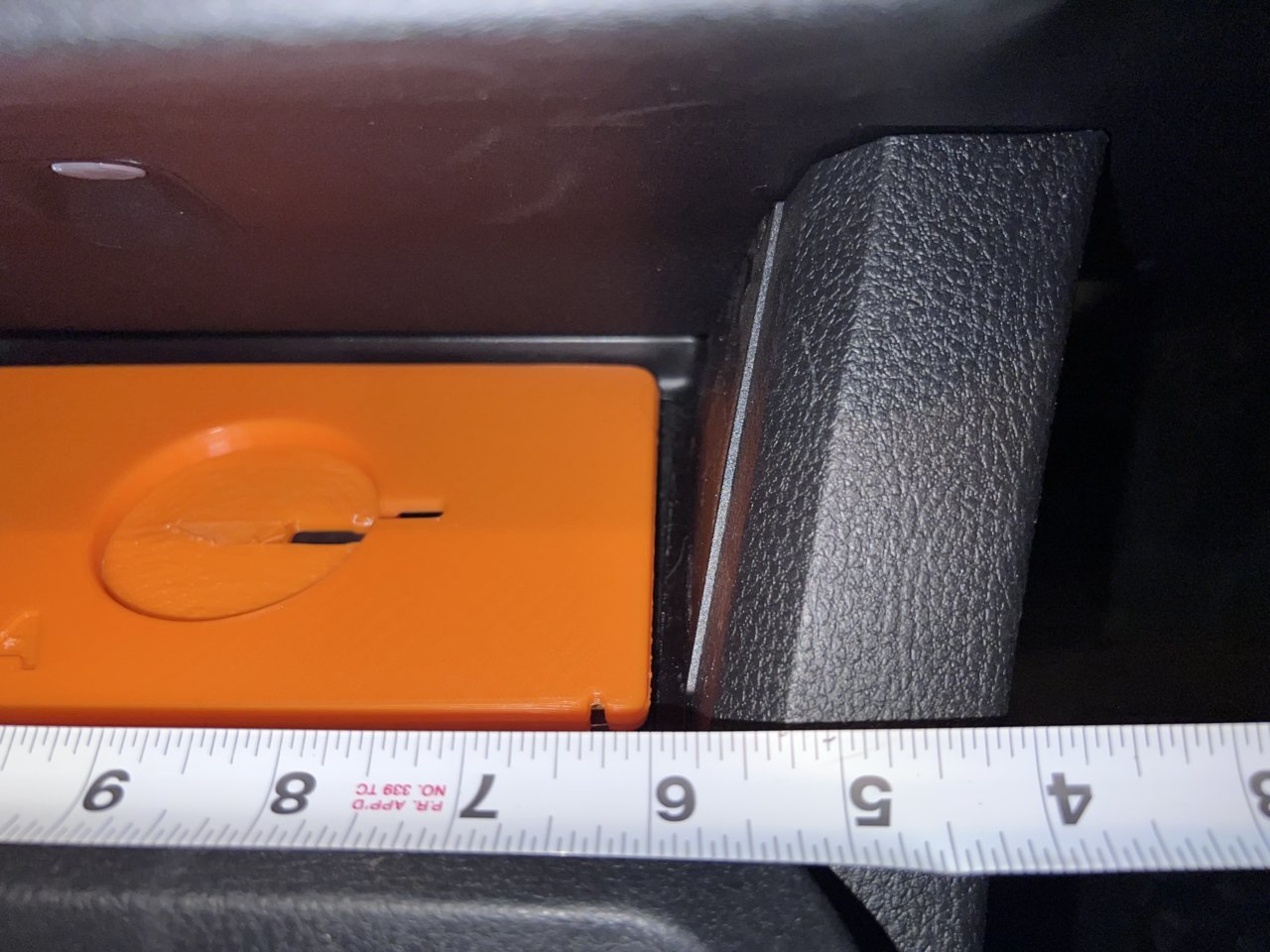

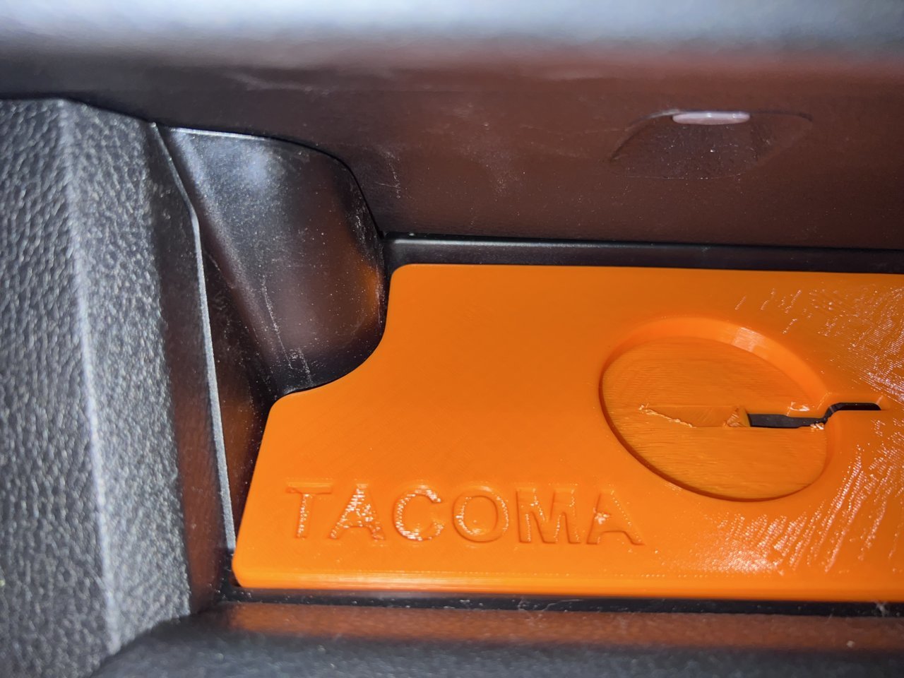

    I despise rattles. I feel that this way, there would be a bit of a rattle. Double stick tape was mentioned before, so that could be a solution indeed, but if this was something that I was going to use I would increase the front to back dimension by .125 (added at the rear side) and the rear edge side to side width by .125 and front edge width by .1875. This would cut down on possible rattles for sure. D073EB9D-C9AF-4A82-BC4C-E89FC37D4D0A.jpg 02BE5336-297D-4599-BD5E-C7A44863B097.jpg
    but, it does fit nicely, and I think that with some DST it won’t rattle.

    ('99) Offset Aluminium Wheels, 31" BFG All-Terrains, Bushwacker Fender Flares, Window and Hood Wind Deflectors ('20) Stock
    Thanks for the feedback!
    V5 will have the recommended adjustments incorporated.
