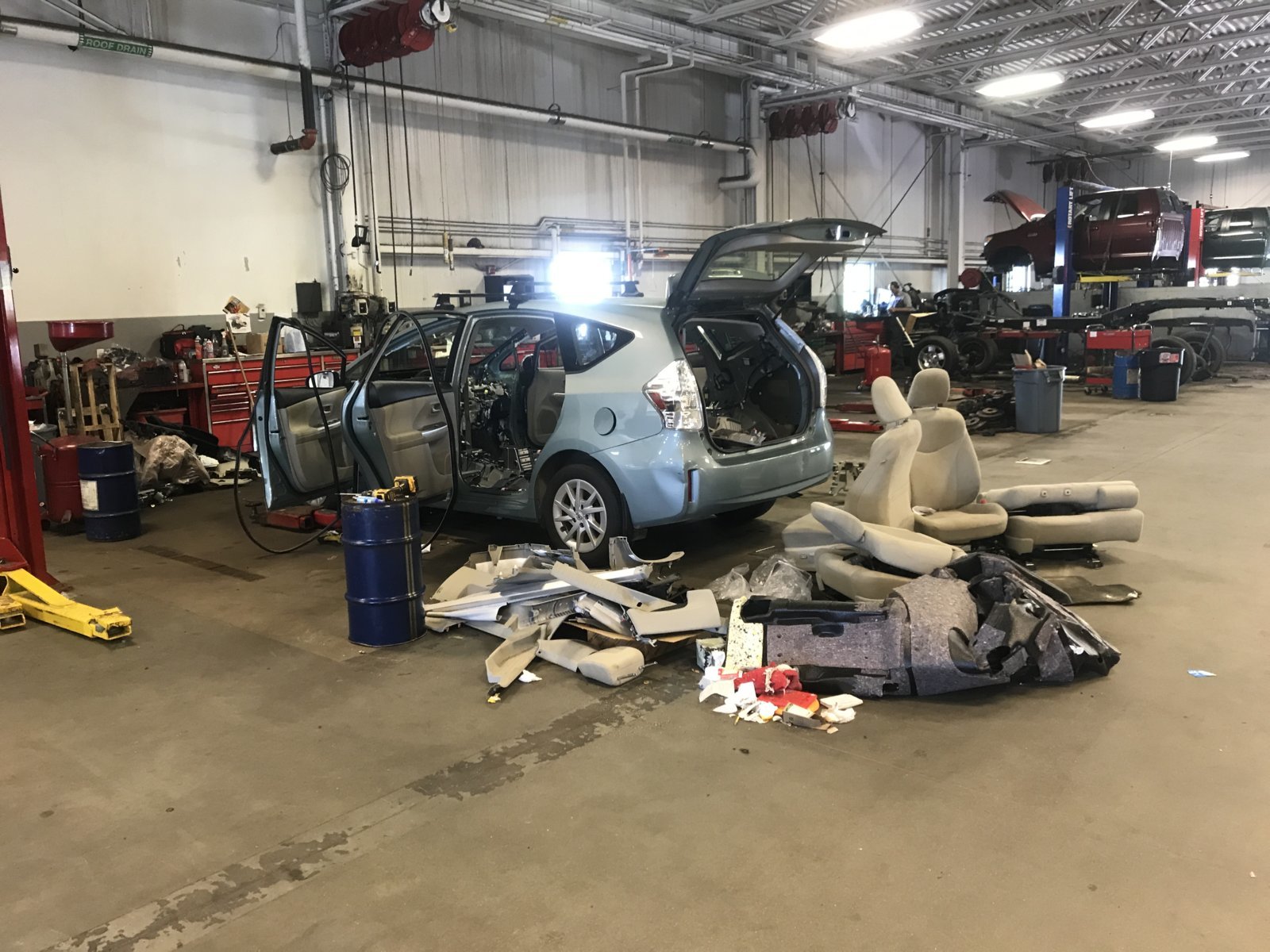

    Removing the two front seats is VERY easy and should take you no more than 10 minutes each.
    1) Remove the headrest and set aside. This tiny step makes it much easier to wiggle the seat out the door.
    2) Remove one 14 mm hex head bolt at each corner of the seat that bolts it to the floor. 4 in total. You can break these easily with a 3/8" drive ratchet and socket. The rear two bolts will require a plastic cover to be removed first. Just gently pry each one off. There are no covers for the front hold-down bolts.
    3) Gently tilt the entire seat backward once the bolts are undone to expose the underside and *carefully* unplug the wiring harness connections under the seat. The driver side has 3 plugs and the pax side 2. Take your time and just look closely for how the release tabs press inward.
    4) Then use the seat tilt adjuster lever on the outboard side of the seat to place the seat in as forward a tilt position as possible. It should almost look like a Vee. Then gently remove seat through the front door being careful not to scratch the door sill. That's it. 10 minutes, per side or one 16 ounce beer.
    Remove door sill plastic trim panels by gently prying upward.
    Remove center console. There are dozens of good videos on YouTube. IIRC, there are a handful of 10mm bolts and the rest is just plastic tabs.
    You may need to remove some bolts for the rear seat to get the carpet out in one fell swoop, but it is as easy as that.
    At most, if this is your first time doing something like this, it should take you no more than a weekend afternoon to get the carpet out.
    Once you get the carpet out, you will be able to decide what you wish to do with padding or sound deadening insulation.
    I'm with others here. If the carpet is otherwise in good condition, just clean it really really good and let it hang or lay in the warm sun on your patio for an entire day. It will fit back in like new (a plus) and save you about $500-$600.
