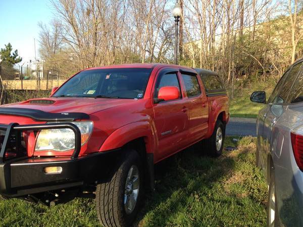

    I love light weight builds. I think it is an awesome idea. I have a stock truck with a camper shell and ARB bumper. heavy choices, but the topper doubles as my sleeping system. I have a sleeping platform and have my light weight backpacking gear underneath. I can fit everything I need for a multi day trip into my truck without the need for a roof rack, RTT, or trailer. This is obviously only for two people, but I have a 3 person tent for other people if need be.
    I don't picture adding much more than sliders and a synthetic line winch. Definitely covers all of my needs, but then again, I don't go hardcore wheeling.
