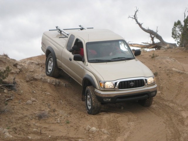

    If I were to do a light weight build:
    1. 1/8" IFS skid
    2. bob the bed
    3. 265/75r16s
    Then I would start a bank account to fund skid fixing and replacements as well as body work. I'd also spend some time learning how to take lines and scouting trails.
    When Toyota added the e-locker, the only competition for off-roading straight off the lot was the Rubicon model Heep. The only downside (and this is arguable) is the IFS. Add a solid axle and the flex gets crazy.
    The aftermarket armor is more about absorbing damage than adding capability. Winches are nice but a tow strap is a lot lighter and works fine in many cases.
    Many moons ago:
