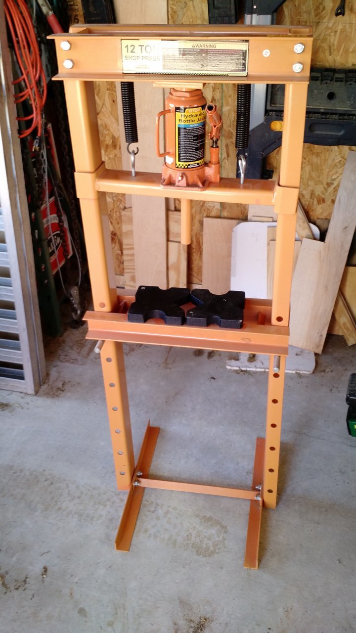

    You need one of these things. It's a hydraulic press available at Harbor Freight for about $100.00, plus a set of bearing tools which are split jaws that hold the bearing while you press it out, and hold the new bearing while you press it in (but I don't have a pic of that tool).
    That's how you do the job right!
    Charlie
    b_r_o likes this.

    To be honest man, unless you plan on keeping the truck forever and changing bearings as needed over many years, don't bother buying all the tools, your best bet...
    Buy all of the parts, bearing assembly (make sure it's for the correct side and setup for ABS), retainer, seal, etc...
    Pull the axle shaft, bring the parts to a good local shop who has experience with Toyota axles, pay $100 or whatever to have them remove the old bearing and press on new parts.
    Go back home and reinstall. Just be gentle, don't damage the seal on the differential side when putting the shaft back in.
    dborrer, broke_down[OP] and kyledamon like this.
