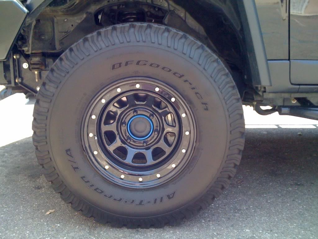

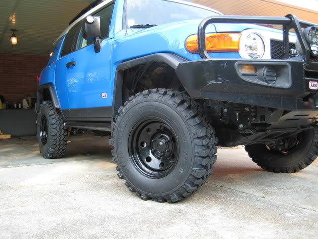

    Right...the 87 can be had with a special part number that has a T at the end for Toyota...it flares out more right after the mounting surface to clear the brake calipers. It is mainly the fact the D windows are stamped in there and that makes them stick in a lot compared to the round 87s.
    These are actually 52s I think but the center is the same... you can see even with a spacer the caliper is right there.
    And the 87s that fit w/o spacers
    Now in 17" I dont think any of this matters...lots of extra room i think at that size.
