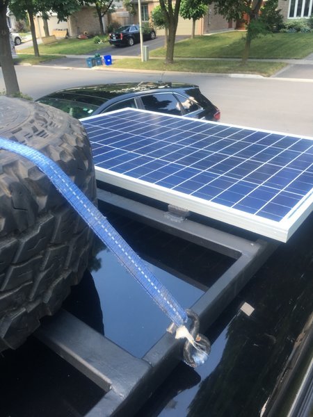

    I had a fibreglass truck cap and then added a rtt. Prior to the rtt I did add the bed stiffeners and they did help. However time of rough roads, rock ledges and general wheeling that didn’t lead to any body damage took its toll.
    If I could go back, I would have done it very differently to avoid the issues I had. I have lost a lot of faith in the bedsides of these beds. Throw some weight in the bed sure. Have some weight on the rails....your looking for issues. There is not structure in the rails. Farm jacks, shovels, even using the rails as tie downs isn’t a good idea (within reason....I would tie down a tank of gas for instance but strapping down a tarp sure).
    Instead of replacing the bed I added a flatbed and essentially had to rebuild my setup. It took about 6 months of going a few hours after work, and also took the “opportunity” to strengthen to the frame to avoid any future issues.

    Added a cap it started to go, added the stiffeners. Then rtt down the road.....the beds aren’t to great.
    When I started to figure out my “build” I looked at so many builds running a cap and rtt. No issues. There are guys running campers and jumping. I don’t know how there isn’t any issues. Maybe there is, maybe the campers are more structurally sound than a fibreglass cap. Lots of variables. I don’t believe it was due to abuse.

    Bed stiffeners did not bend. The bedside pulled away from the support.
    Then battery got relocated to bed and rtt and stiffeners added
    Again considering other setups I didn’t think it was crazy or any different. Especially those with water tanks on their rails. I did have a hi lift jack. Tire was setup in this configuration but strapped to the floor
    I was 6k CND for the bed and cap....

    Hindsight is always 20/20. Tacoma16 must have had every bit of 400 pounds, probably more, hanging off the top of the bed. Cap, roof rack,tire, battery and other stuff in tool boxes. It seems, from what he said, that the bed side sheet metal was peeling off the bed frame work, skimpy as it is. Wow, unbelievable.

    Leer cap, window in the rear and aluminum doors I believe. It has been a year since it has been gone if I remember correctly so I may be wrong.
    Biggest thing is to be mindful. Stiffeners help but they aren’t a for sure thing as I had thought
