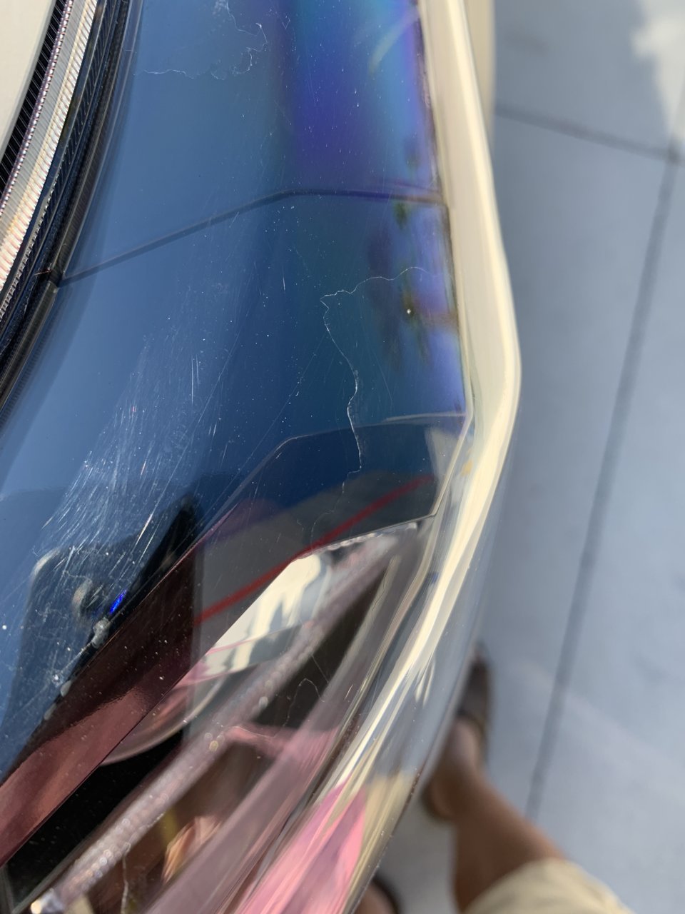

    Rujack
    Rujack [OP] Stop Global Whining
    Aug 16, 2016
    #194732
    2,447
    2016 Tacoma TRD Off Road 6 speed manual
    Oh yeah. Prob gonna need a little luck then

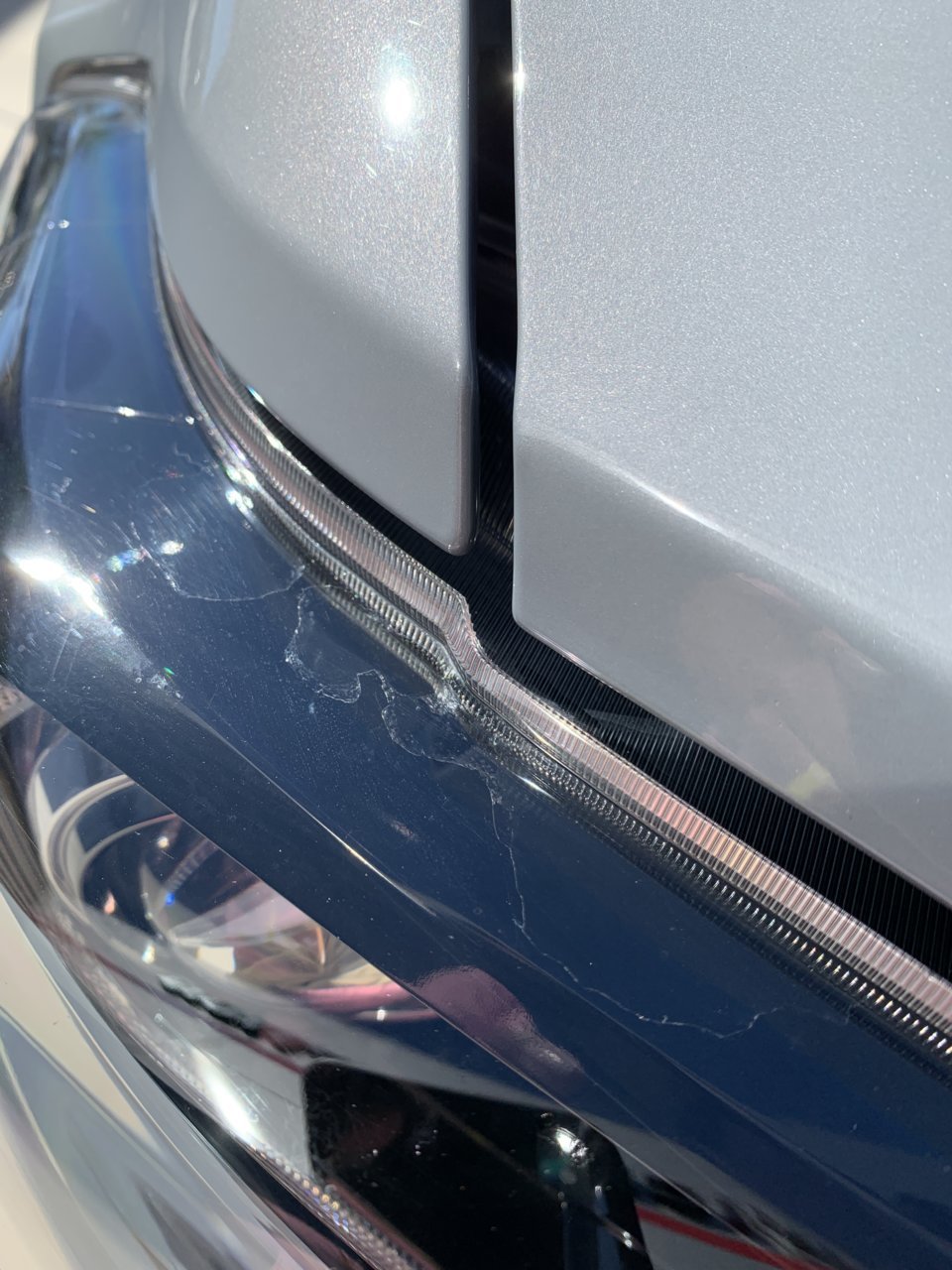

    I noticed that my coating had started peeling a few months back, but just brushed off any notion of Toyota replacing them thinking that they would be considered wear and tear. I did some research and came across these posts and decided to head to the dealership to let them look at it. The advisor looked at it, then went and got the service Manager to look at it and he agreed that it should not be happening and said that it will be covered under the Basic 3 year/36K warranty. He said he hasn’t seen a Tacoma with that problem yet and had the advisor take pictures to establish a case report for Toyota. While there I also mentioned the black rubberized roof railing was fading and they agreed that it will be replaced also. They said they will be opening a repair order and will call when the parts are in, keeping my fingers crossed and waiting for a phone call.

    Toyota replaced both of my headlamps under the Basic Warranty. The Advisor was shocked, she told me they were $1400 a piece. Glad I inquired about the peeling after reading posts here on TW. If yours show any signs of peeling, take them in and have it documented and hopefully replaced.

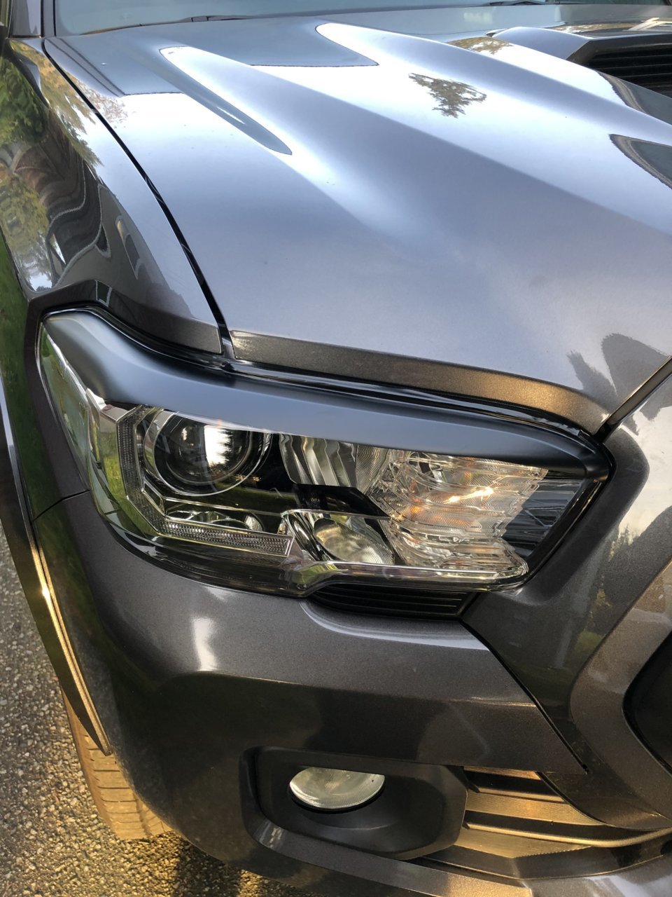

    I had the same thing happen. Lucky it was covered under warranty. This is what I did as a preventative measure for future.

    OOO I like, reminds me of the "eye brows" we used to put on old BMWs
    You use vinyl or paint?

    That looks good, mind sharing the details?

    I like this!! I may grab a sheet of laminx and do it in clear, but it’s a great idea

    I got the idea off a Tundra forum. You need to make a stencil out of painters tape first. Add a few layers of painters tape directly on the lens and shape the upper area of the lens. Gently peel off your new stencil mask. Trace it on a piece of cardboard as you will need to use this as a template for tracing on to vinyl for both left and right side of the headlight (1 side right/ 1 side left). Cut and apply vinyl with a heat gun.

    Don't use laminx, use Xpel.
