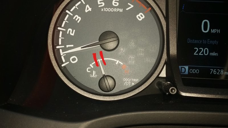

    Maybe someone else is experiencing the below described issue? My truck is scheduled to go to the dealer this Friday (1-6-17) for this issue.
    Basically, before the truck reaches its normal operating temperature the transmission will bang or thump during the 2nd to 1st gear downshift, just before a stop. The downshift banging and thumping is most noticeable when the temperature gauge needle is sitting dead on the 2nd bold mark. At normal operating temperature, the transmission is smooth as glass on both the up and downshifts. Let the truck sit over night or for a few hours and that downshift banging returns.
