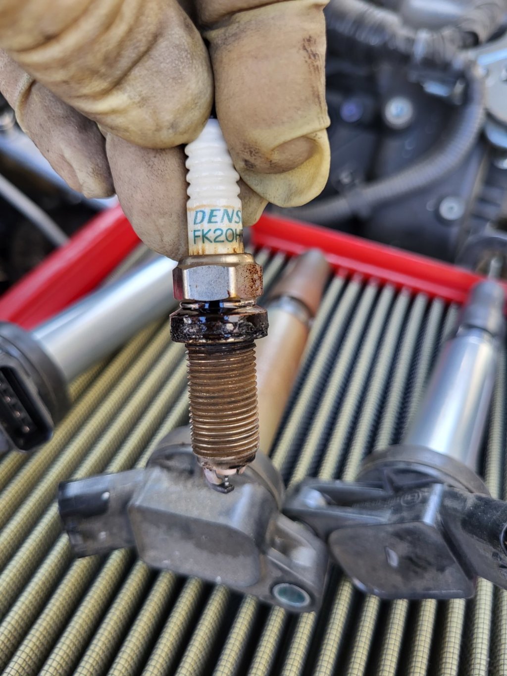

    I completely agree.
    I'm a Toyota specialist mechanic. I've changed spark plugs on several 3rd gens. Out of over a dozen, 2 of them had loose spark plugs from the factory. Both on the passenger side. Spark plug covered in burnt oil since that cylinder had blow by through the spark plug hole. That is completely unacceptable aside from all the other 3rd gen engine failures like timing cover leaks that almost ALL of them have or will have. It's sad honestly because I love Toyota as a brand, manufacturer and awesome car maker.

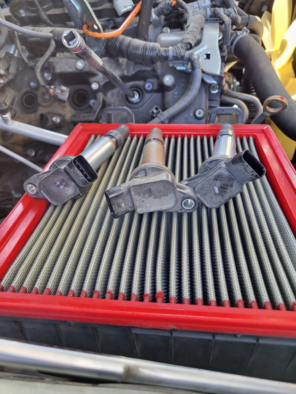

    These are my photos below on a recent 3rd gen spark plug change at 58k miles. Thank God the customer decided to change plugs on time. Middle cylinder on PS the spark plug was super loose. The coil pack even got soaked in oil.

    Plug seal faulty?

    You mean the crush washer?
    No. 5 out of 6 normal. 6th hand loose,
    came out by hand, loose as a goose, fancy free, loose as a buy one get one free, for free, free spirit. The spark plug was ready to jump out of it's hole.
    Burnt oil everywhere. Never seen any manufacturer leave spark plugs loose. Either they need to up their spark plug torque spec, or check their torque wrenches at the factory.

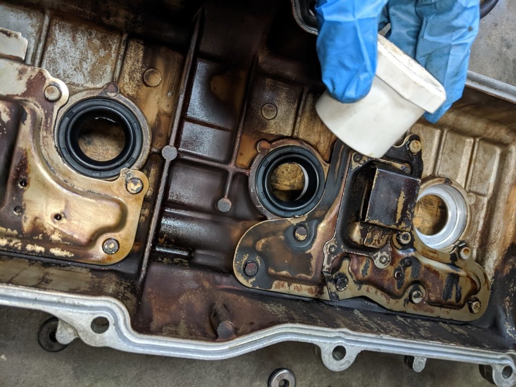

    Sorry, the seal on the spark plug tube. This is a pic from the 3.4, assuming the 3.5 is similar.
    Did the loose plug damage it, causing the leak?

    Got it. No, it's not that. Spark plug actually super loose.
