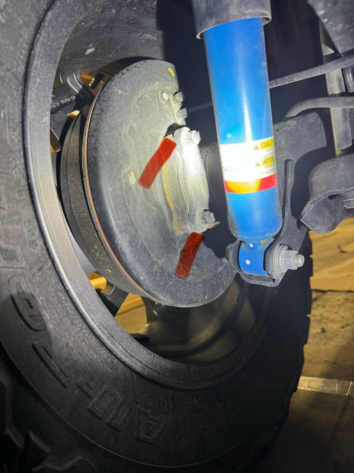

    Checked my VIN for my newly purchased 23 TRD Sport and indeed it is subject to the recall. Checked the nuts today and found them to be tight and secure. Because of the tight spacing, I was only able to get my torque wrench effectively on 2 nuts per side but they were adequately torqued (i.e. they didn't turn at 30 ft-lb. I checked the rest with a ratchet wrench - couldn't turn them tighter with reasonable effort so I reckon I'm good until Toyota issues more guidance.

    Well, my 3/8" torque wrench would not go high enough so I had to use my 1/2" one. It was a bit of a challenge with limited space and I was not able to use it on 2 out of 4 nuts on each side. None of the nuts checked with torque or ratchet would budge so I'm assuming I'm good until toyota issues more guidance.

    Just checked my rear axle and I see welding slag all on the ends of both axle tubes but the 4 nuts on each side are snug . Looks like no welding slag near or under the nuts. I’m good to go. Will have to have the dealer check it out but I see no issues with mine
  19. Feb 29, 2024 at 8:40 PM
