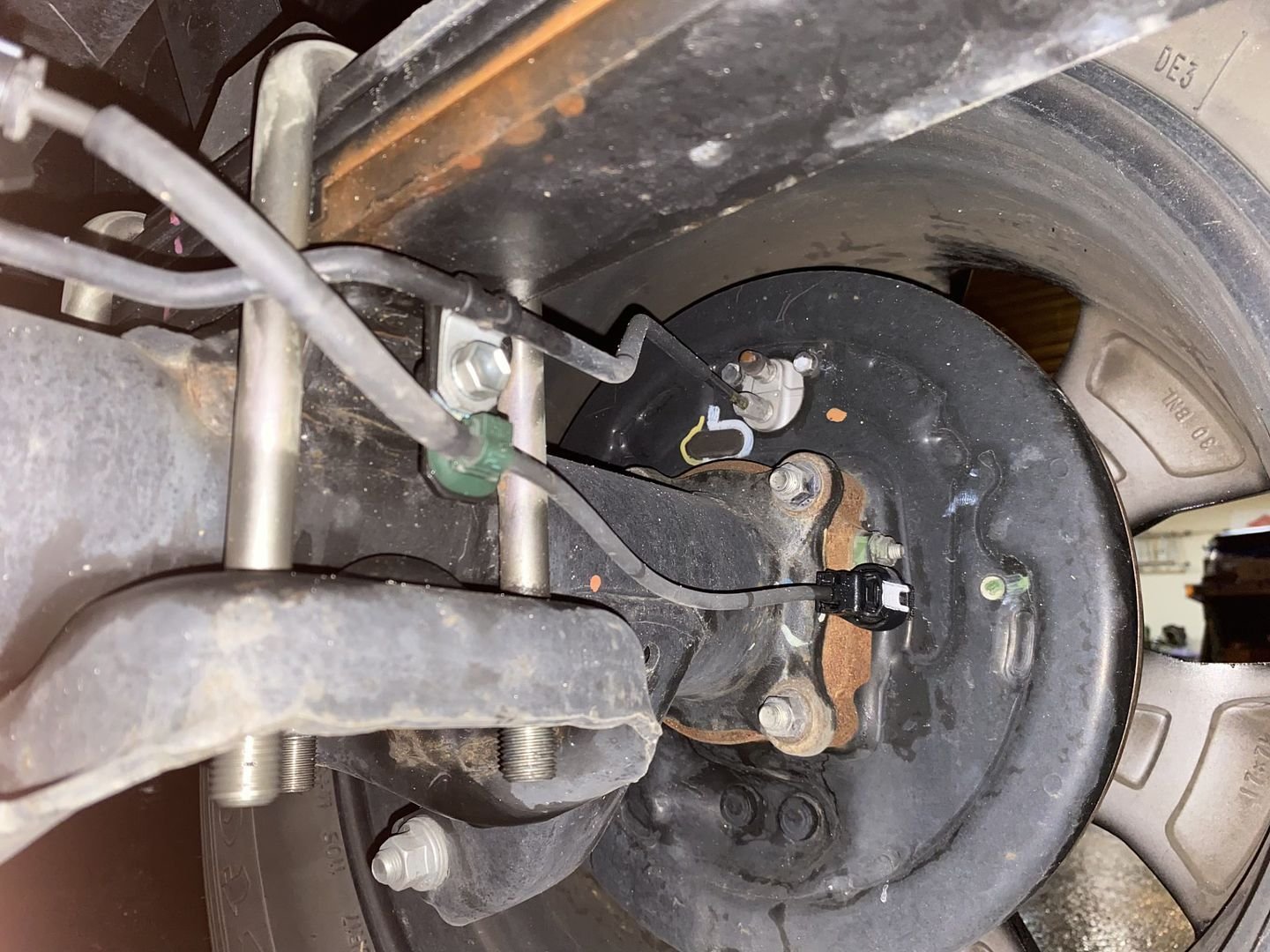

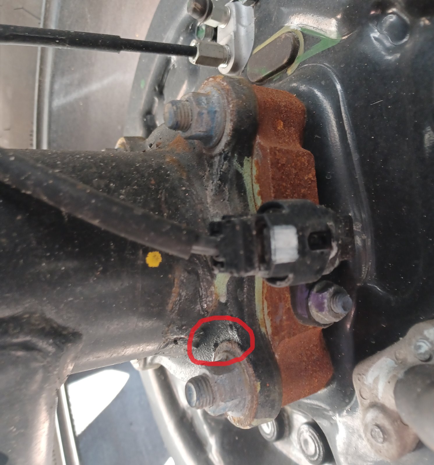

    New 2023 sr5. Able to get a shorty socket on 3/8 drive torque wrench on all nuts, none loose. Two were a challenge to wiggle the socket back off. Flanges look tight.
    From forward side I could get my head in there, from rear side I could not.
    Did not see this weld spatter in photo below until afterwards.... close to raised boss but not interfering with washer.
    Truck has been on the road for five weeks, we haven't figured out how to build them with more rust resistance?
