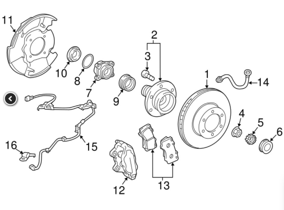

    I'd sure like to know precisely which nuts they're talking about. Using the words from the recall "axle retaining nut", I see this parts diagram from TRD Shop: Seems to indicate part #4. I'd like to just inspect all of this myself. Maybe the first person going in for the recall can get better info and post it.

    The diagram you pulled up is from the wrong end of the truck.

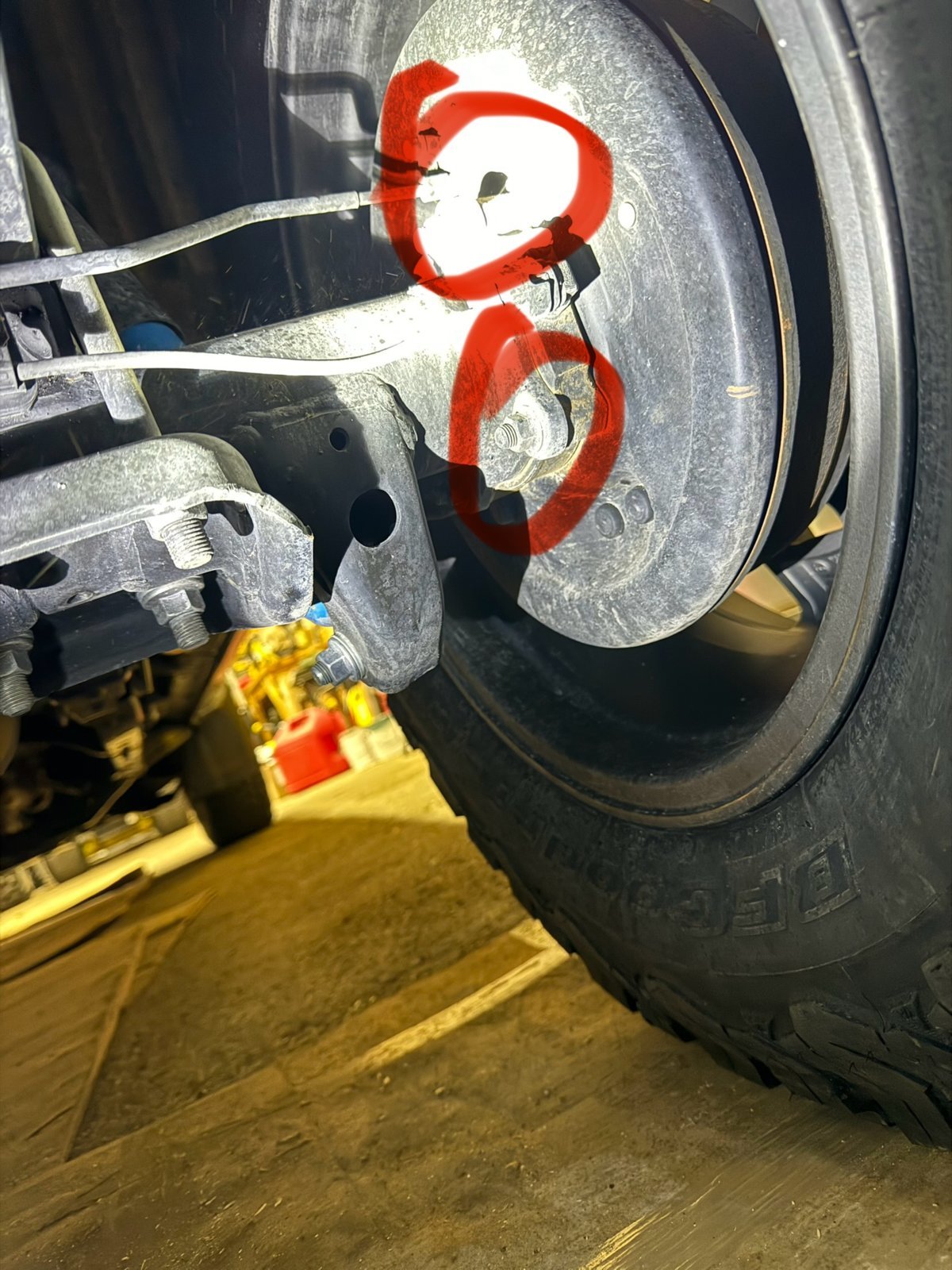

    The recall pertains to the rear axle. The axle retainer plate is located outboard of the axle bearing. This plate along with a seal is installed on the outboard end of the axle housing and is held on with four studs and four nuts.
    The four nuts are the hardware in question in this recall. Poor picture but two are circled below. if you read the thread, you’ll find at least one or two more pictures.

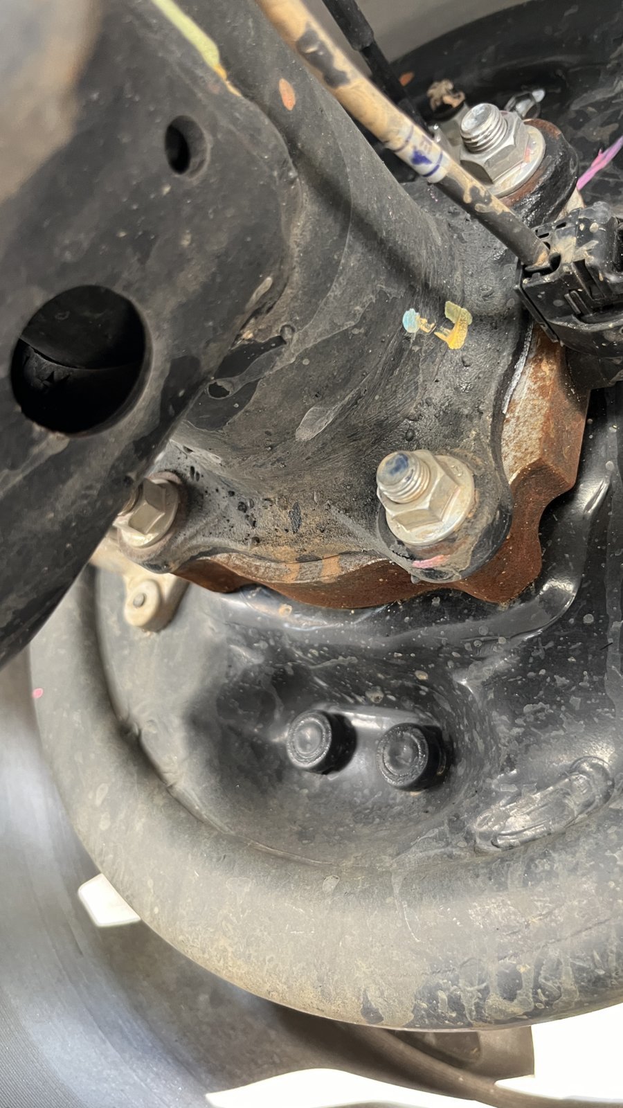

    Removed nuts, one at a time. No welding spatter present. Reinstalled, retorqued.

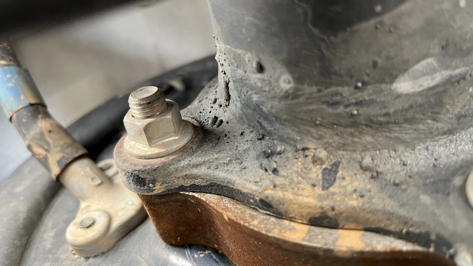

    I took a look under my 2023 Offroad 4x4 out of curiosity and saw some weld spatter around the area in question. Haven't read the entire thread and maybe someone already mentioned it but this is probably what the recall is about.
