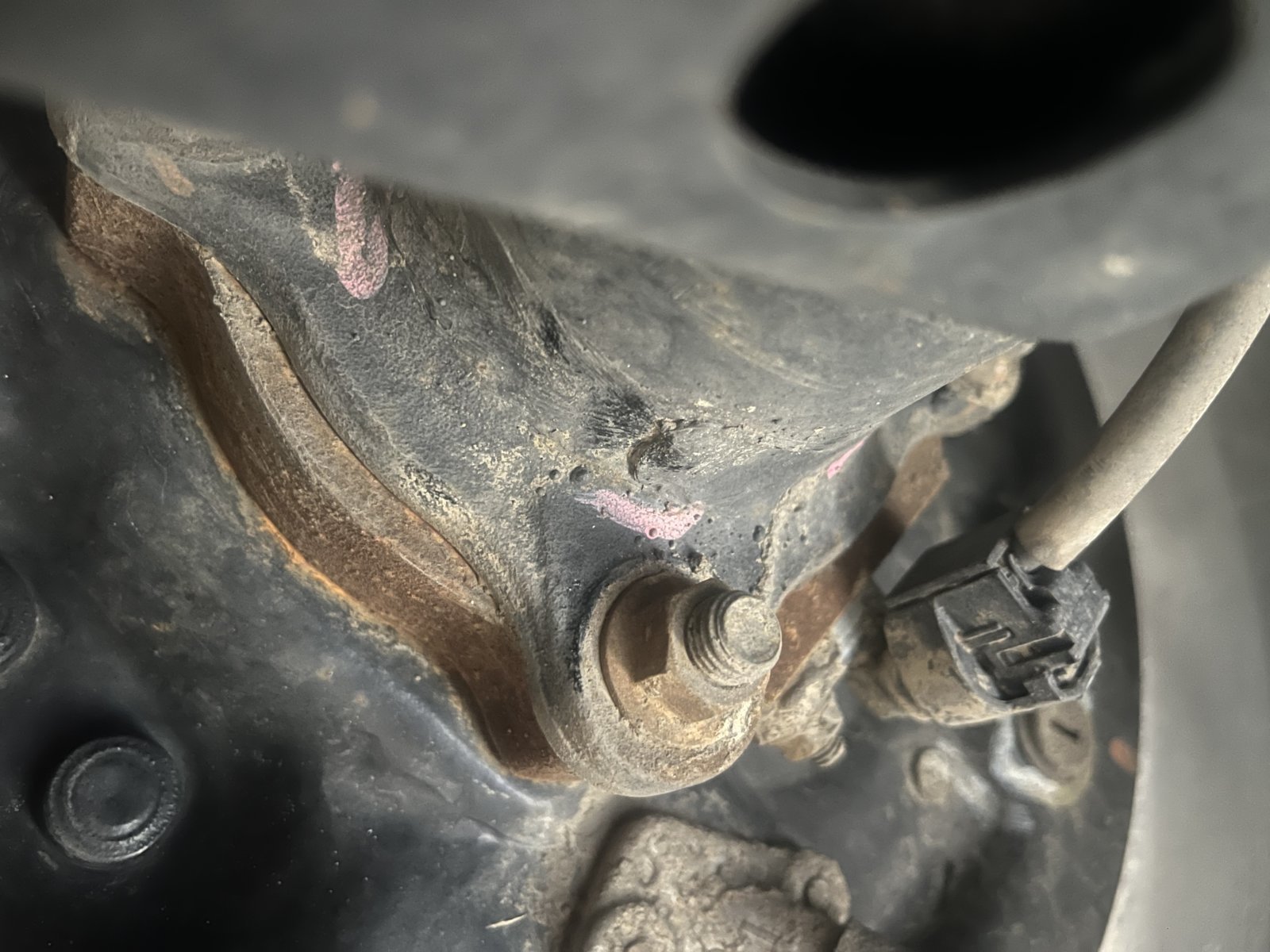

    Now im no mechanic/welder/ but mine looks like a lot of slag?

    Whoever inspected your rear axle, and put red markers, cannot see slags. Or really do not give a chit.

    Those marks are from the factory, it has not been inspected from the recall.

    Yeah, that nut in the picture - looks like a tiny spot actually touching the edge of the nut at 7 o'clock, possibly at noon too? Feel free to put a wrench on there quick just to make sure it is snug, and check back once in a while until it can be taken in officially.

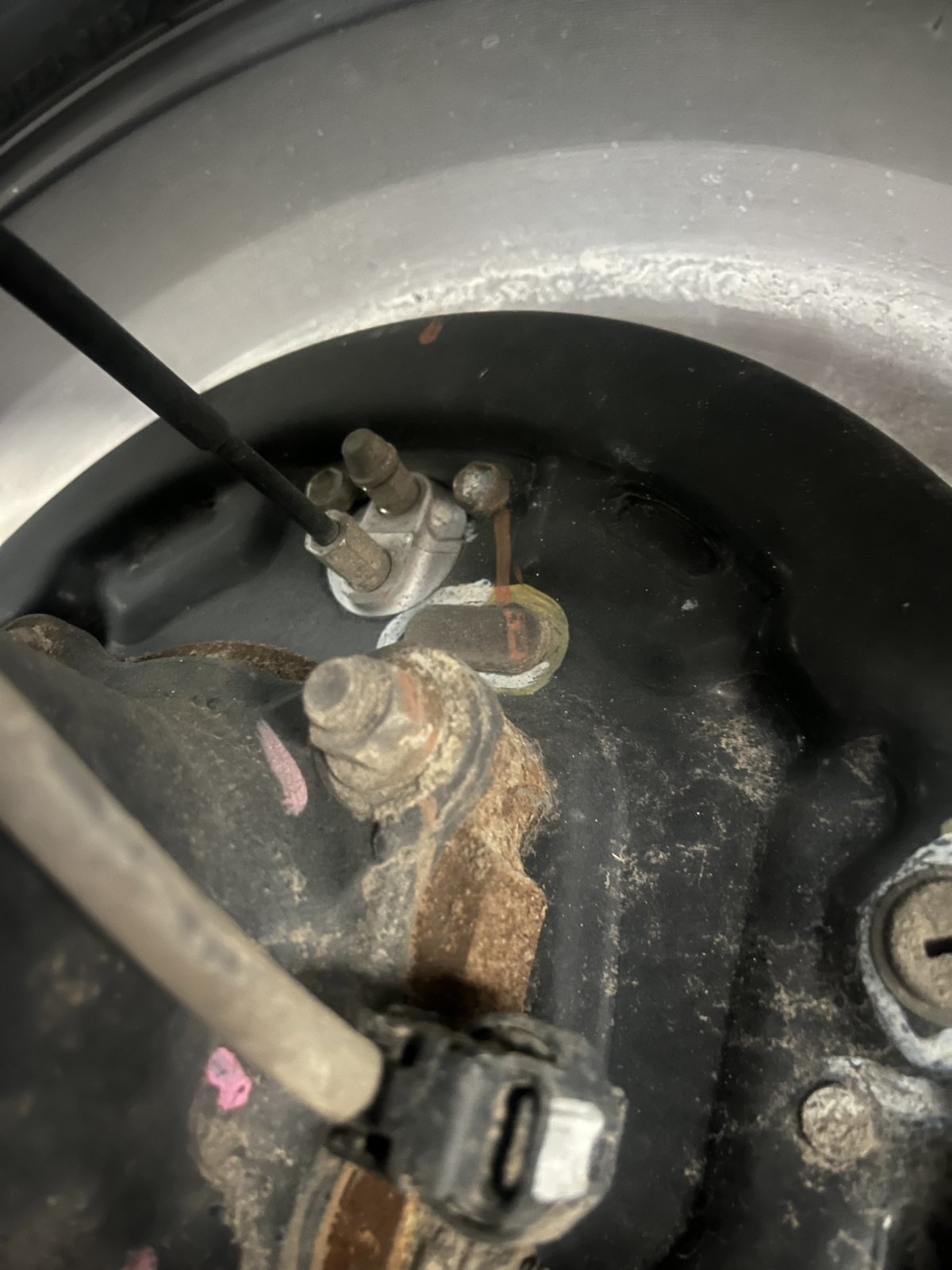

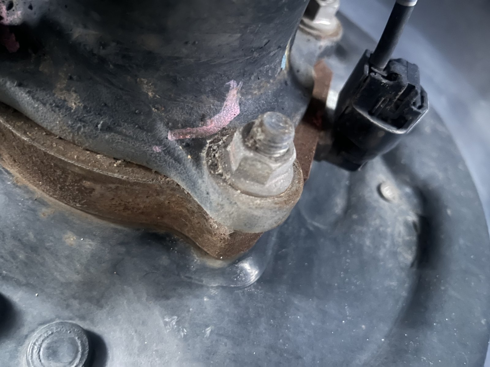

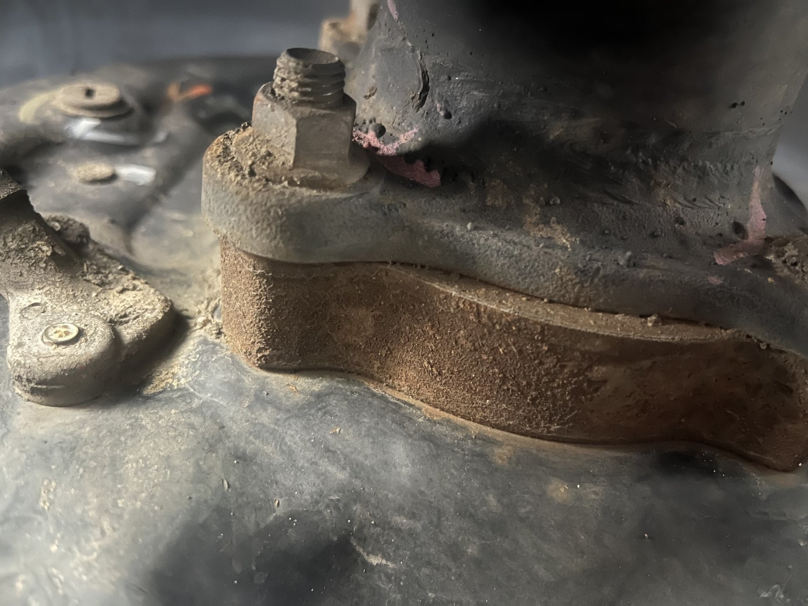

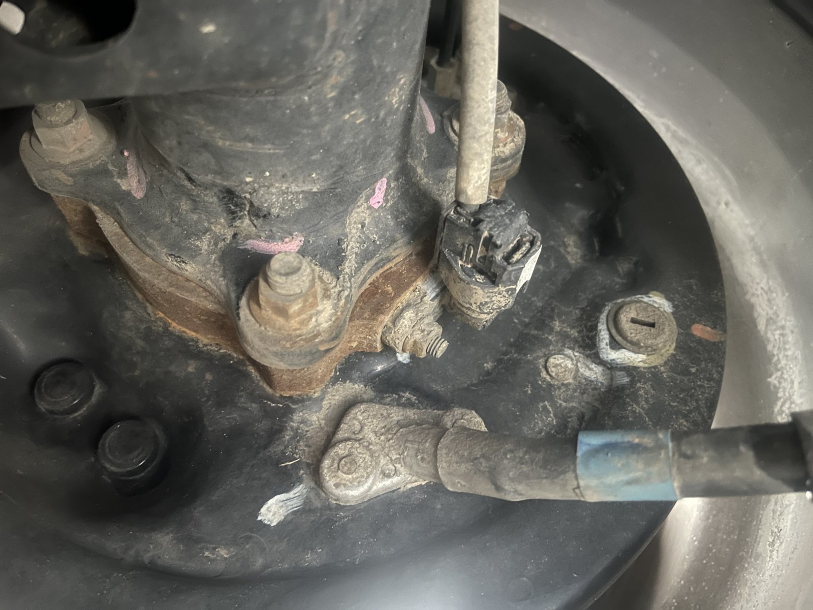

    I called my dealership and asked if they would do an inspection before the recall and they said I would know/feel it if something was wrong. These are all the pics I took. Think its worth pushing for them to retorque?

    Cripes. Those first two pics... does anyone know, do they do any welding after the nuts are installed? Looks like slag on the nuts themselves?
    Can you take a wire brush to them quick and see if that comes off, like gumpy dirt? Just seems weird seeing that there... but I also make the statement I am no real welder...

    I am not going to take a wire brush to it just incase it is slag, I want them to see it. But I am going out wheeling this weekend so will jump under there tonight and see if I can remove it with my hand/double check the nuts are tight

    The welding slag you’re showing is nothing new.
    Go look at any 5th gen 4runner and I’m willing to bet most of the them have the exact same weld “slag” and those are built in a completely different factory in quality control capital of the world.

    So the key thing to look at is the nuts not being seated. The problem isn’t the welding spatter that you can see, It’s all about what is or is not on the nut seating surface
