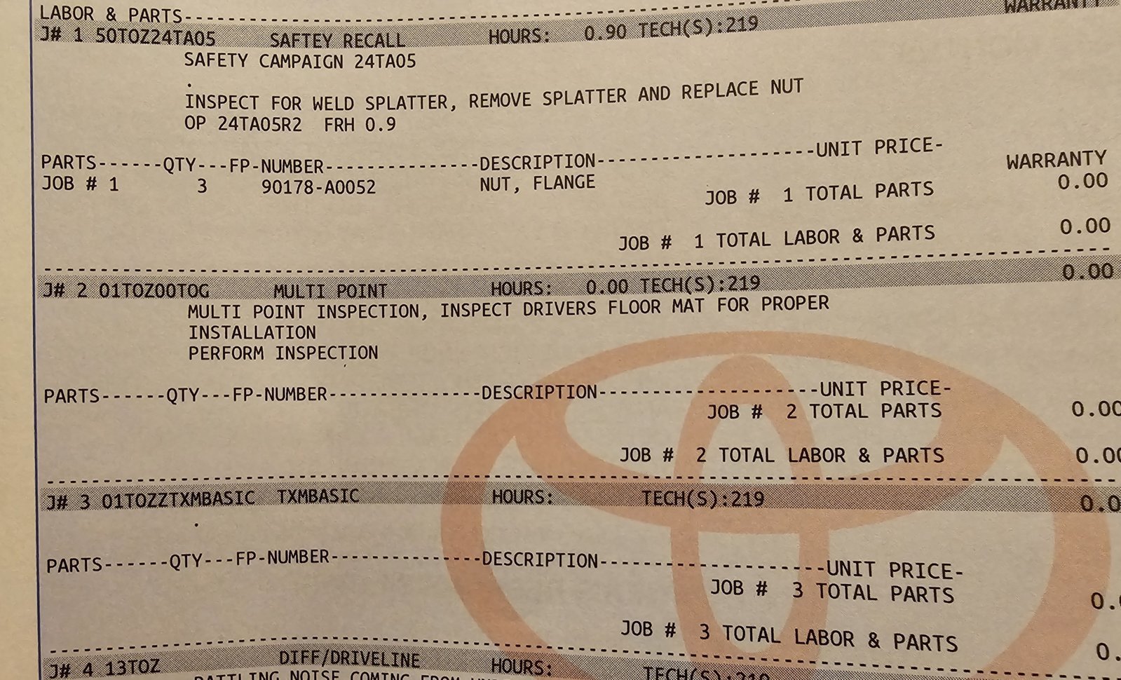

    I took my truck in yesterday Tuesday. They replaced three nuts on the passenger side of the axle. They did find minor amounts of welding slag on the mating surface. The mechanic said it likely wouldn't have been a problem but they cleaned it up, replaced the nuts and torque them down.

    Just got the recall letter yesterday. Found these TSBs on NHSTA recall website listing. It looks like the torque has increased to 41 ft·lb. I wonder if the chiseling and filing could make the axle flange contact area out of square? Ford recently uncovered a problem with the majority of their recalls being done by untrained techs and started to deny payment unless the tech performing the repair had completed recent training.

    I stopped at my local dealer today. They said that everything was fine.Torqued the nuts to 41ft lbs. They said that that is all that has been needed on the trucks that they have seen.
