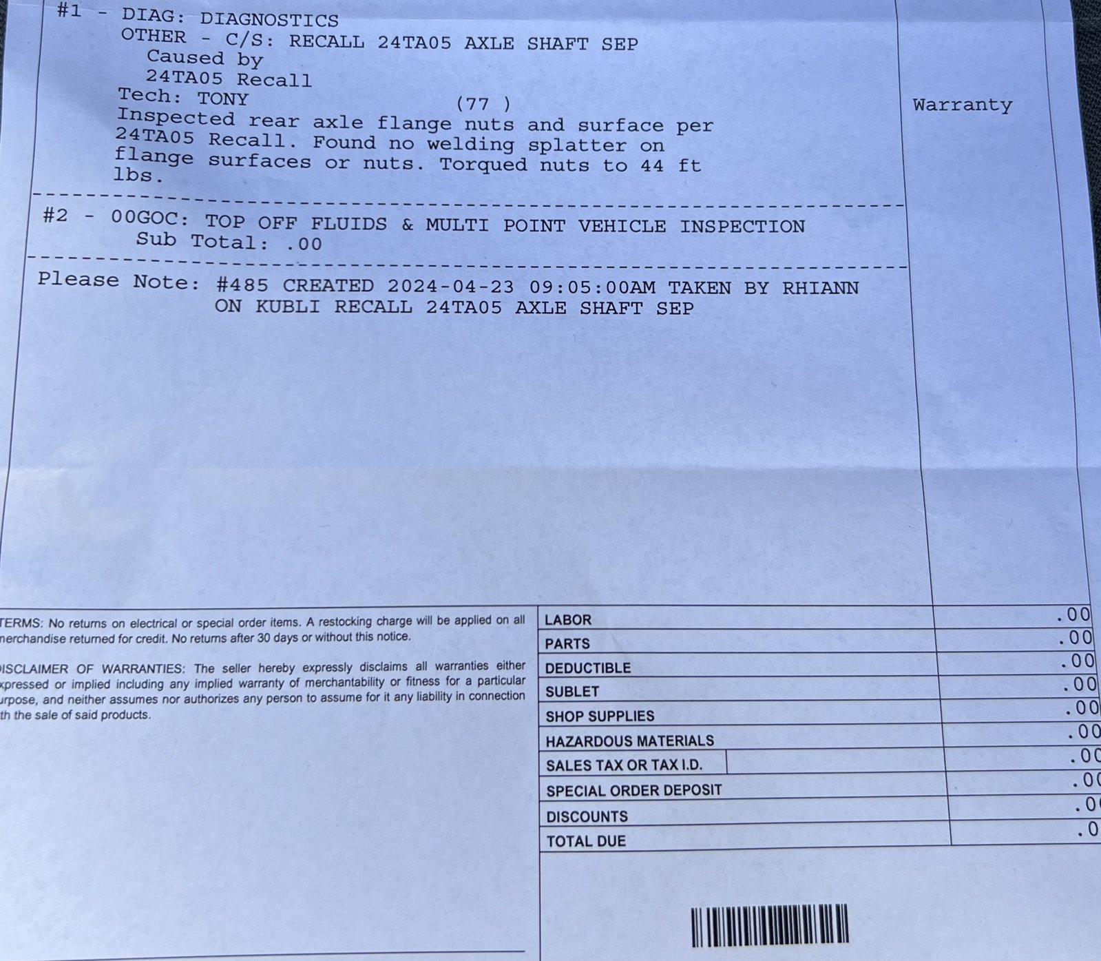

    just got the recall work done today, same time as my free 1yr service (oil change). peaked under my truck beforehand so I could have an idea of what to expect and looked clean as a whistle.
    dealership came back with the same thing, no weld slag observed upon inspection, except they didn’t retorque anything. service advisor didn’t mention it and it’s not on the work order, I had other shit to do so didn’t think about that part until later. anyone think I need to follow up and have them torque the nuts?
    to be honest I don’t trust the dealership, but going there for at least the 2 years free service. plus don’t really have a choice if I want the recall work performance signed off. but rather not have them touch anything, and not sure I see why it should be retorqued if it was apparently unaffected. curious what others think

    Now I don’t know anymore they torqued yours to 44 ft. lbs. and the service bulletin says 41 ft. lbs. I don’t think they know themselves. Another member uploaded his service ticket and it noted 41 ft. lbs. ‍

    Yeah, I saw that too. I’m sure the 3lbs extra will be okay.

    It's not that it is, or isn't, ok... what is the exact mindset of upping from the original torque value? Is this to compensate for the threads now being "used / stretched" to accomplish the same holding force as in a new factory install setting? Genually curious.
    And if it's drifting up to 44 now in at least once dealer instance, at what point does it become a concern? That's getting to be a fairly high percent up from the original value. Or conversely, why isn't it that from the factory then?
    A dealer not being able to answer these types of questions is why I hesitate to let them just do stuff... YMMV
  12. Apr 28, 2024 at 5:28 AM
    #412
    t0p_d0g
    t0p_d0g 私はタコマが大好きです
    Apr 17, 2023
    #422653
    2,037
    2023 TRD SPORT 4X4 DCSB CSM, 2004 TRD OR DCSB IRP
    I checked all of mine for welding spatter then re-torqued to 33ft. lbs. and as far as I’m concerned recall is complete until I sell it. My thought is when you start increasing the torque from what the engineers originally set it at you can damage the integrity of the threads. If it was just a few pounds of torque maybe, but 44 ft. lbs. is around 34% increase.
