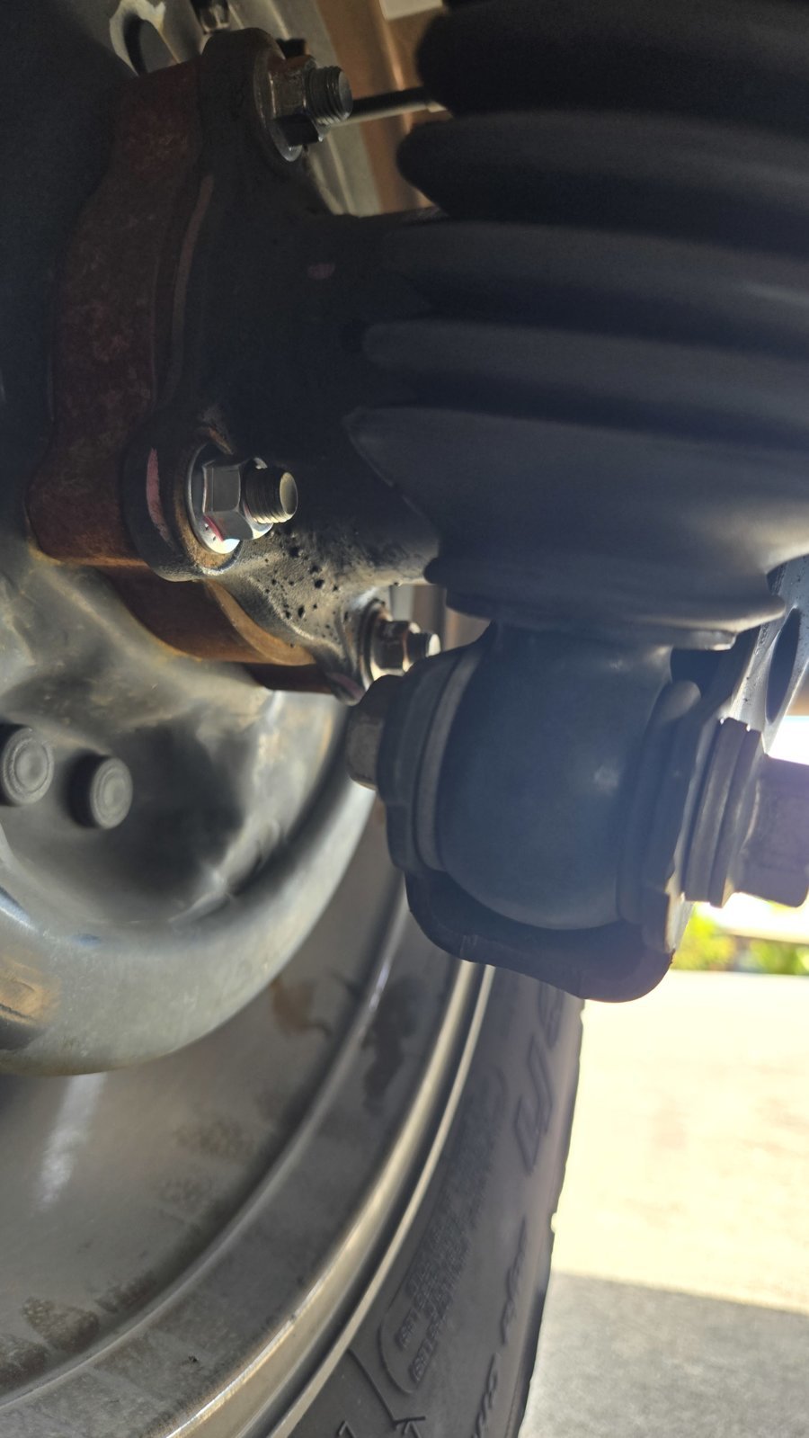

    Got my recall checked out today, I had 1 nut replaced on the passenger side. Looking under the truck, I guess you can kinda see some weld splatter. Im guessing the nut replacement is to ensure that if there was weld splatter under a nut that it is replaced just in case the nut was comprised by the weld splatter? Can anyone shed some like on the nut replacement?20240430_150445.jpg

    Your line of thinking is correct. Essentially the weld spatter gouges the nut when it’s tightened. Since this is a recall, any nuts are replaced following removal of the spatter.
    Also keep in mind, the torque spec changed to 41 lbs ft
