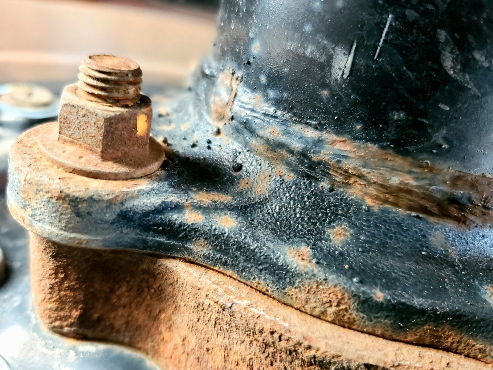

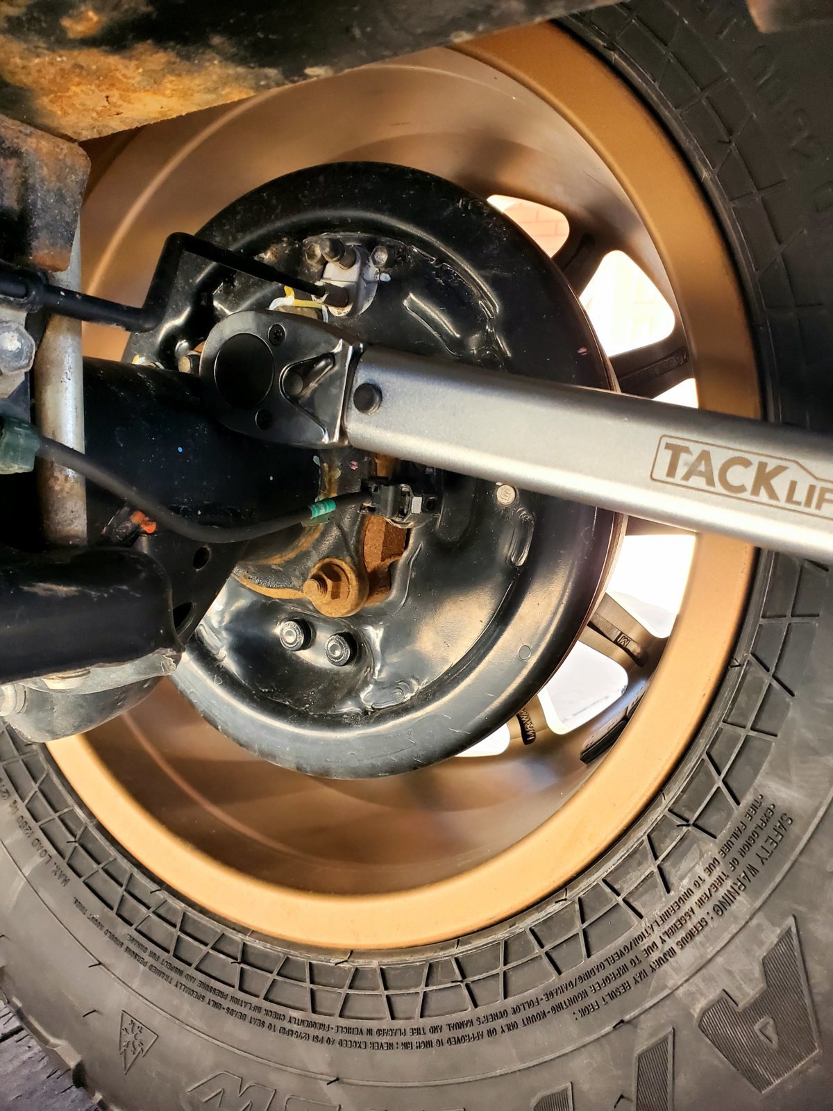

    So I just got under there and gave it a shot with a 1/2" torque wrench. It's too big. Gonna need a 3/8", which I don't have. The struts are in the way and and even with s 6" extension, the u bolt bracket is in the way as well.
    The nuts are 14mm for anyone wondering.
    Might need a shallow 14mm with a 3/8" torque wrench. I guess if I wanted to, I could just get a normal 14mm wrench and get her cranked, but now I'm chasing 27ft lbs lol the one on each side I was able to do had a quarter turn each until 27ft lbs, so I'd guess mine were at 23-25ft lbs??
    Anyway, here's a look at the "welding debris". If I saw this on my own, no recall, wouldn't really raise any alarms to me, but I'm no welder :crazy:

    Update on my earlier post, my Tacoma, the one in my profile pic, has an August 2022 build date. In regards to the photos of the “weld debris” in the post above this one, if they are leaving weld spatter like that on the outside where everyone can see it, it makes me wonder what kind of mess is on the inside of that diff.

    Here's a pic of my 2021's area of concern. Looking for a difference in assembly.
    Does it look like there's a washer in between the nut...or is it a one-piece?

    Thanks for the pic. I can see where a small metal glob could inhibit proper torquing of a single nut, but IMO it would be a stretch to result in all four nuts being loose. In any case, not a biggie to check. I reckon I'll have to check the calibration om my 3/8" torque wrench.

    Another view...only for comparison.

    One piece for sure

    Lmk how it goes. Don't really want to buy another torque wrench just for this if the stealership will retorque 8 weeks from now. They don't seem like they're going anywhere honestly.
    Although it does beg the question, at enough torque (not sure how much it would be) wouldn't the nut "squish" the debris/splatter? It doesn't seem concentrated enough to impede the nut in my case

    I threw a shallow 14mm socket on my normal ratchet and gave all of the bolts a small tug. Only 2 on the driver side moved a hair. Prob just because I was over the 27 ft pounds. Being on my back with just a 12 inch ratchet I can't really apply that much force but In my opinion everything is tight. The 2 that moved I prob ended up over tightening a bit.
