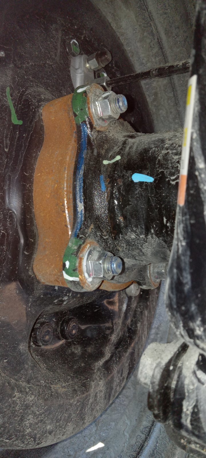

    As far as weld splatter goes:
    My Tacoma doesn’t have the recall but has some weld splatter.
    For reference ,My 2020 5th gen 4runner has substantially more weld splatter on that same weld.

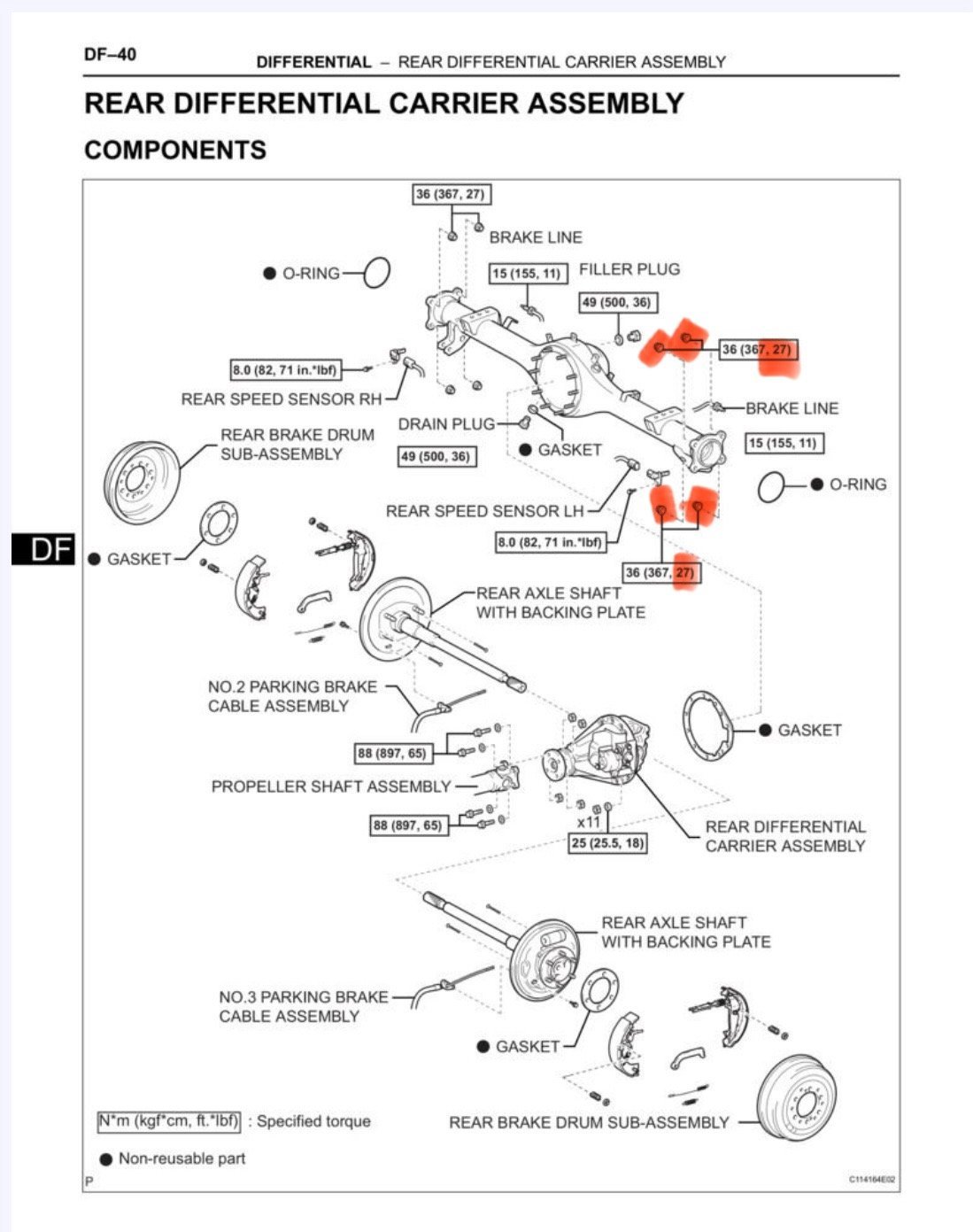

    Yes, need a 3/8” torque wrench
    I used a standard 14mm 12 point socket
    Check with local parts stores. Most “rent” tools, would suspect you can get one there. Not sure where you are at, could use mine if local.

    Crawl under the truck and check the bolts referenced in the pictures. If they were truly lose you have different symptoms than just bad alignment. You would have all sorts of shaking, clunking and potentially brake issues.

    Yesterday, I checked the torque on the nuts and they were fine. After wiping some dust and dirt off the area, I could still see the factory "mating marks" (white paint pen). They were still in alignment.

    I’m listed, got under at checked torque. All still new in appearance(haven’t got it wet yet lol!). All 8 clicked at 33ft pounds. Probably would have clicked at 35 so my truck ain’t going no where..
    14,400 on odometer, towing a single axle box about 3000lbs for half the mileage for reference.

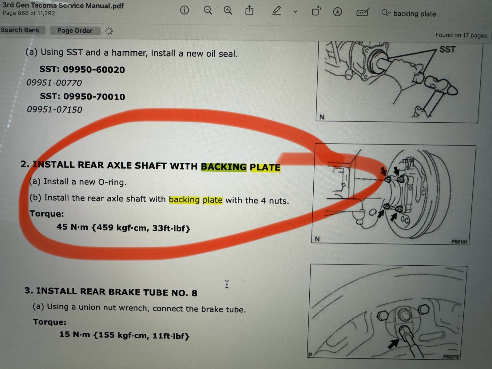

    my apologies, I quoted a figure I was giving with a chart for a service manual. It appears it was incorrect. I’m not sure what year that was from. I personally looked at the service menu this morning, the nuts in question are to be torque to 33 lbs ft

    wish I'd known, mine are good at 27ft.lb. and none of them budged. I will say it was a tight fit with my cdi 3/8" clicker and a 14mm 6pt., but it fit. My only crow foot sockets are sae. Weld looks good.

    Finding two different values for the torque now: 36NM and 45NM. Which ist the right one now?

    read what I posted above. You copied the picture I took from the service manual. Read what I typed
