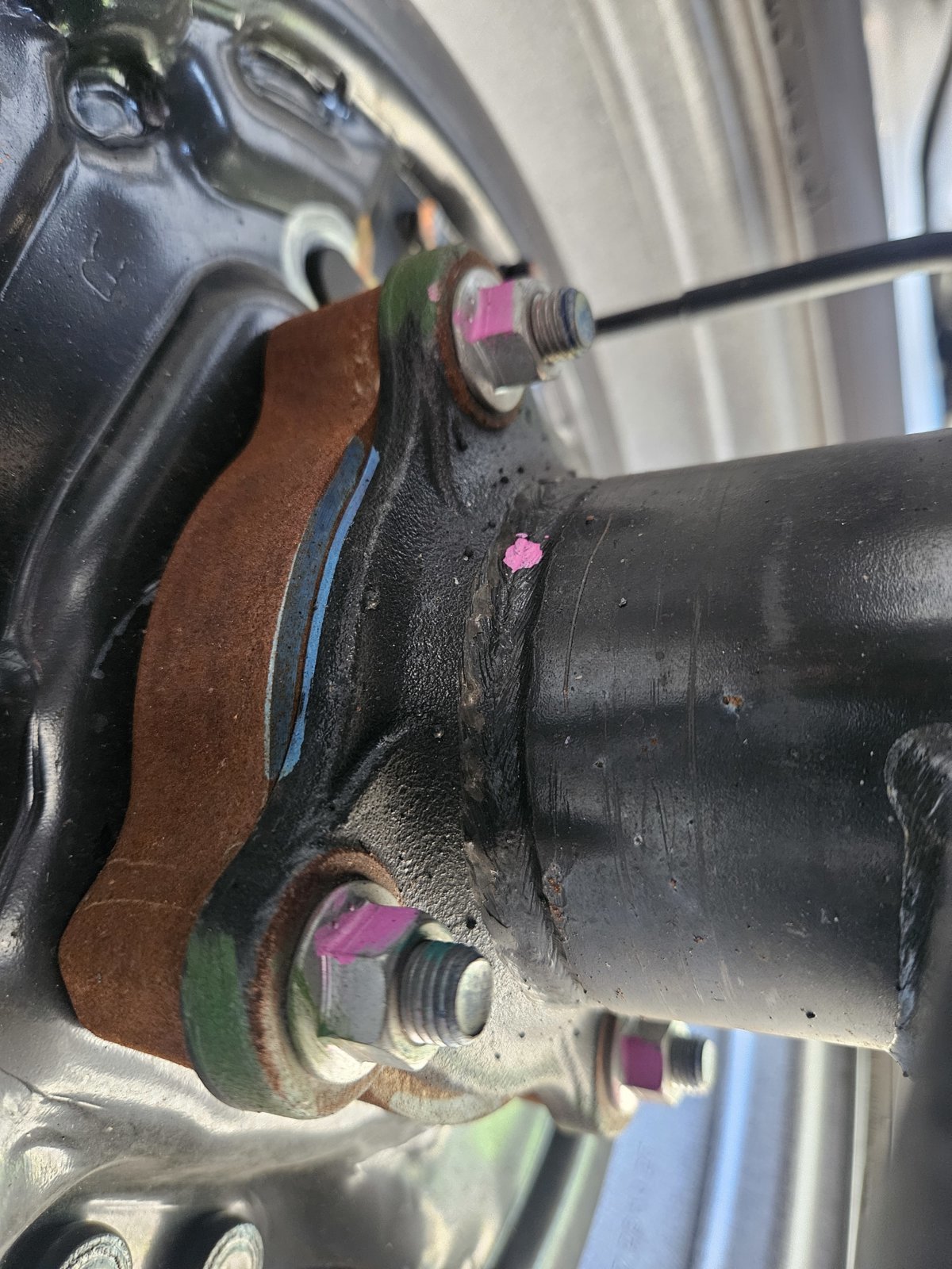

    This is photo of rear axle flange. Nobody sprays road salt, or whatever in my location, no need. Paint marks from factory still there, did not move. I put socket wrench on flange nuts, they are tight.

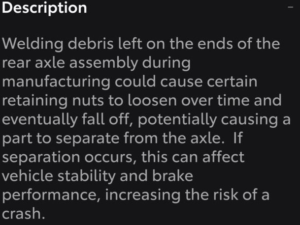

    Found that link to the 3rd Gen service manual. Download the PDF to your workstation.
    It has 11,292 pages so opening in a web browser is both slow and problematic.
    My copy has no cover page or index, and appears to be a partial lift from a more complete PDF.
    It still has a huge amount of useful information.
    https://www.toyota.com/recall
    I entered my VIN and got the recall notice.
    My production date is October 2023.
    24TA05 (Interim 24TB05) - Potential Axle Shaft Separation

    Just looked at mines and is the pink dot supposed to line up with the green mark?

    You know, while y'all are under there - if you happen to move them a bit yourself while tightening or correcting may be a good idea to do a repaint of a set mark. That way you can tell if it's still creeping around after you touch it ??? If you come back later and only see un-matched factory marks... may cause unneeded concern.

    The recall references nuts, not bolts. Also, it is fairly specific as to the location and cause, which is welding spatter causing the nuts to loosen and fall off. I looked around under there, and do not see any other areas where welding Debris would even interfere with any nuts. Just the ends of the axle tube where it welds to the flange for the axle retaining bolts, which also hold the backing plate for the drum brake assembly and bearing
