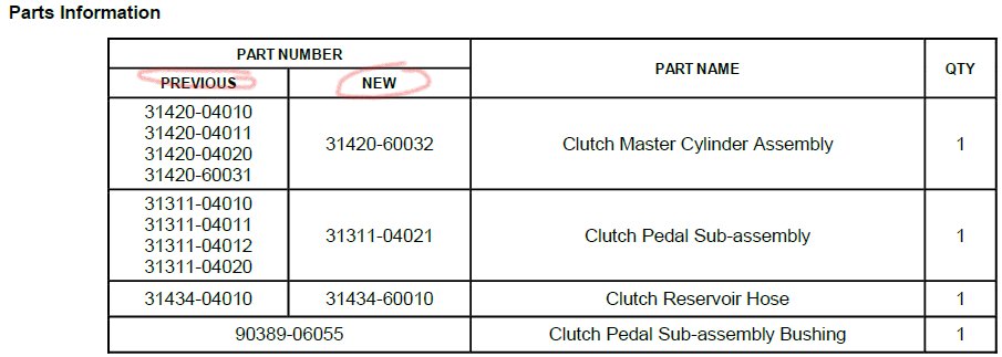

    Are we looking at the same TSB? From TSB-0112-19:
    DTaco18[QUOTED] likes this.

    I noted in the other thread. The master is an unlikely culprit for the issue and the pedal was shown to be about $170:
    https://www.walmart.com/ip/Genuine-...W3YwlVDXz_biAORinODiPEPmzWp77-iIaAhdREALw_wcB
    It isn't cheap, but if it starts getting bad at 70k or so, it could be a whole lot worse, esp if you consider some of the out of warranty issues on FCA and GM stuff.

    Thanks! I was only looking at the front page that was linked. That indeed is a new part number for the assembly.
    That's good to hear. I shall stop lubricating mine starting....now...

    Prior to this new TSB and some folks getting the parts swapped, most posts were about folks having issues with the TSB installation. Mainly bad wrenching by the techs. Lately, there hasn't been any complaints, but I'm still holding my breath. I have about 7k more left on the warranty.
    The full TSB can be found at nthsa.gov.
