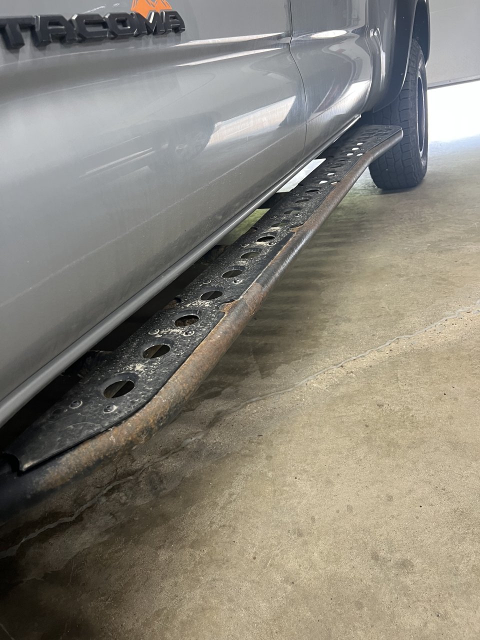

    I have had two sets. First with a kickout and bed liner. Bought them used. It would chip and flake off on huge chunks. But I sold that pair, buyer didn’t care.
    Next set I ordered direct with powder coating and no kickout. later on 8-12 months I noticed rust popping through the coating. They (the one in Los Angeles area) said they would pull them and re-coat the powder coat. And they had heard it from other customers. They were having them coated in the area I guess. But I have no desire nor time to get my ass down to LA.
    So I thought about washing them with some de-iron and seeing if it’s just flecks on the surface. If not eventually I’ll strip them and rattle can em. They are off the truck now anyway.

    Typical chinese junk and typical response. IF. They were made here AND powdercoatrd here they would have made a different response.
    Welcome to manufacturing in china

    I work for a company that manufacturers powder coated porch railing and fencing, all built to AAMA 2604 or 2605, certified PCI 4000. For any type of powder coating to give up the ghost that quickly, regardless of environment, is absolute garbage. I work in sales and not the QI/QC side of things. But I would 100% consider this a very thin application over an improperly cleaned/prepared surface.

    I live on the seacoast of NH, so pretty much the worst case scenario for rust.
    I had a powder coated front skid plate on my 2nd Gen that eventually rusted, but it took a few years.
    That experience taught me to:
    1) stay on top of my annual frame spraying
    2) Use aluminum for anything exposed (skids, bars, etc.)
    If aluminum isn’t available, I’d coat the steel part using something I could maintain on my own and inspect it frequently.
    From my experience, rust will start from even a minor defect in the coating (rock chip, etc.) then spread under the coating until it just flakes off in big chunks if you don’t repair it.

    This can happen if the powder coat goes over oxidation. Ideally you sand blast the sliders first, then zinc primer, then powdercoat. It’s much more expensive, but results in much more corrosion resistance.
