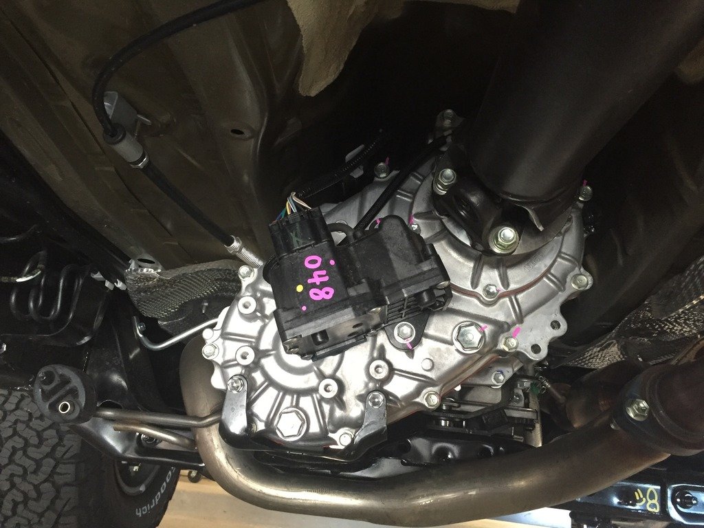

  5. Feb 8, 2016 at 12:18 PM
    #25
    tgear.shead
    tgear.shead Well-Known Member
    Aug 20, 2015
    #162276
    1,734
    Really? I don't think so.... in the image below, the piece with the pink letters "048" is the actuator. Comes off with 2 big bolts. And yes, that is a picture of a 2016.
    Anybody having problems with the actuator not working, lift the back wheels *slightly* off the ground, just enough to turn the wheels, remove the actuator, and you can manually move the shaft into the right place you need it. Then reinstall the actuator so it doesn't spray oil out all over the place.

    Kilokato
    Kilokato Go Vols!
    Nov 24, 2008
    #10996
    830
    George
    East Tennessee
    2016 SR5 Access Cab V6 Auto 4wd
    Limited wheels, extra rope hooks in bed.
    That is correct....They have to take the transfer case out and split it apparently. The service guy I talked to seemed pretty knowledgeable about it.
    The above picture is of the actuator but it's the fingers that go into the case that are the issue. He said not to worry that it's not a transmission problem, just the transfer case which is a fairly simple gear box. He also said Borg-Warner is producing the cases now.

  16. Feb 10, 2016 at 6:48 AM
    #36
    lee261
    lee261 Active Member
    Nov 22, 2015
    #170373
    26
    After reading theses stories , glad I have a 2 wheel drive !
  17. Feb 10, 2016 at 7:16 AM
    #37
    thepinktaco
    thepinktaco Well-Known Member
    Jul 4, 2013
    #107608
    691
    Cody
    Orange, MA
    95 SAS Tacoma, 99 4runner, 16 Tacoma.
    Thats how they come from the factory, Toyota uses orange gasket sealer on gear oil and atf applications. The only units they rebuild are transmissions, alternators, starters, hybrid batteries, and a few other things. Just like most things now a days its throw away.
    It does just unbolt but the shift rods go into the transfer case and have retaining rings on the forks. You have to take the back half of the case apart to get the actuator out.
  18. Feb 10, 2016 at 7:54 AM
    #38
    tgear.shead
    Aug 20, 2015
    #162276
    1,734
    You're talking about something different then -- the shift fork. If the shift fork is stuck or broken, then it won't help to replace the actuator.
