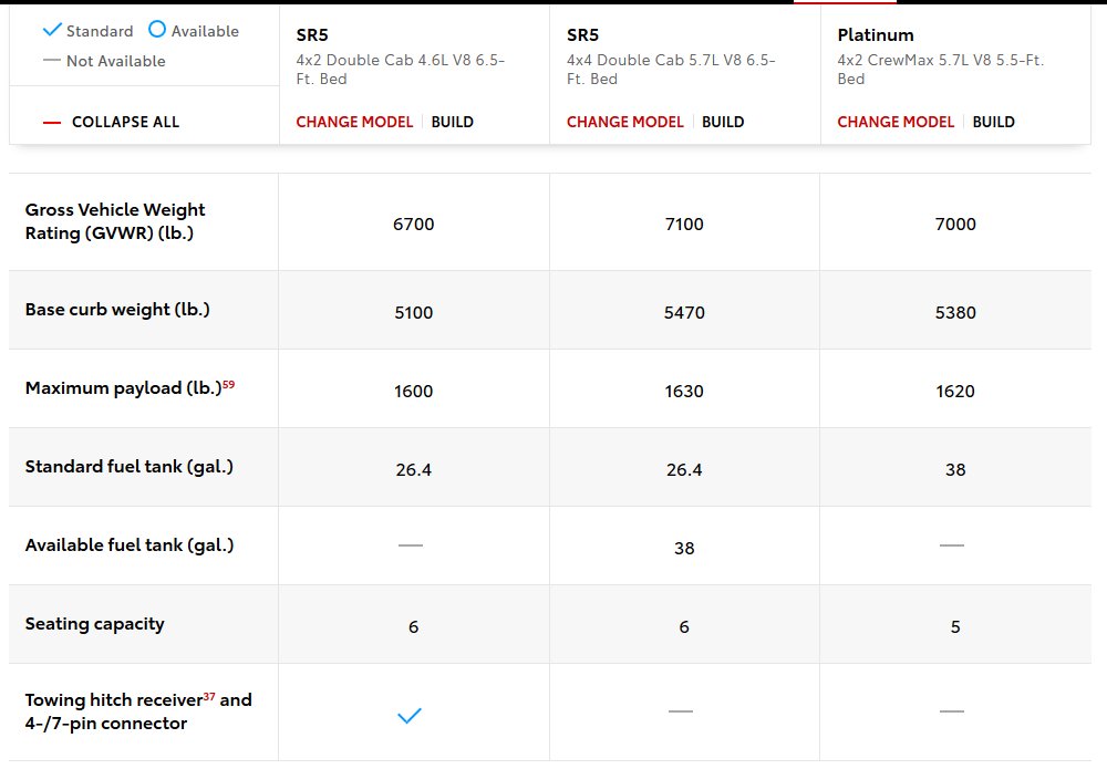

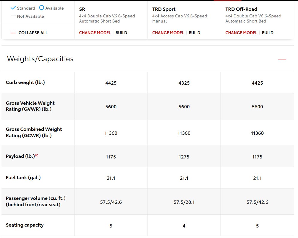

    A lot of it has to do with the Tacoma getting bigger over time. The difference in width between my Tundra and the 05+ is only 2.5" per side although the length can be much different (like a double cab with 8 foot bed). The Tacoma isn't really a "small" or "compact" truck anymore given that they all typically weigh over 4000lbs at this point. Toyota no longer produces a regular cab of any variant anymore (nor does Ram make a 1500 regular cab any longer). A typical "half-ton" will have at least 400-500 lbs more payload capacity than a typical Tacoma. Even just 500 pounds of payload difference is a large fractional change.
