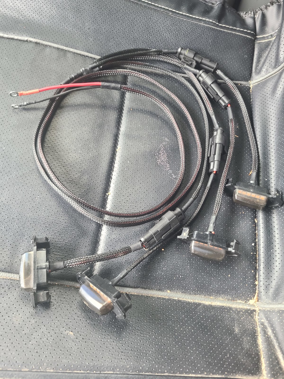

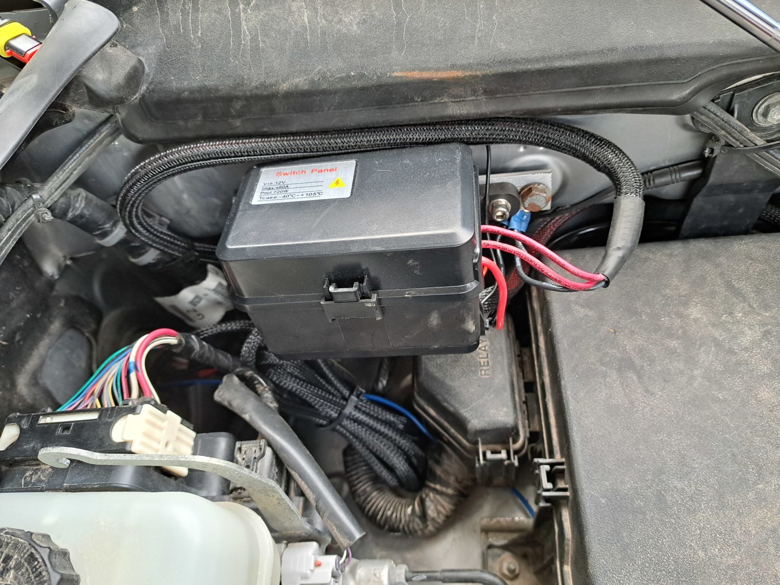

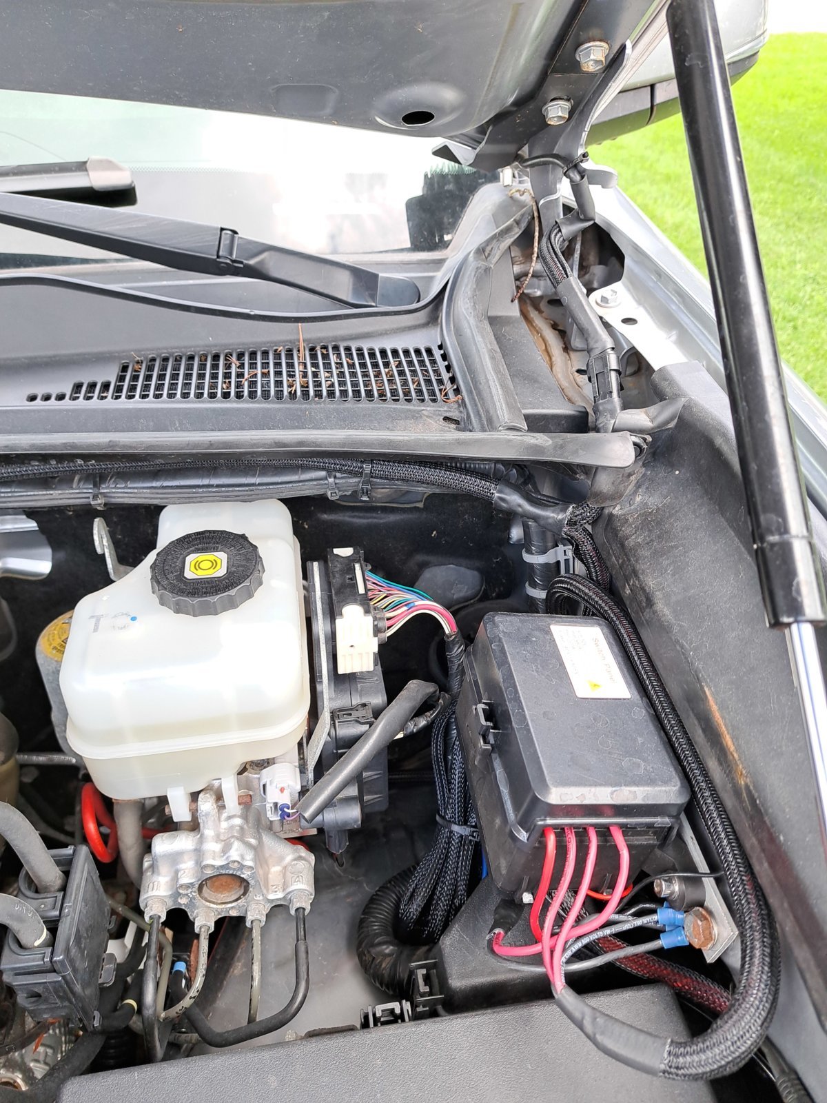

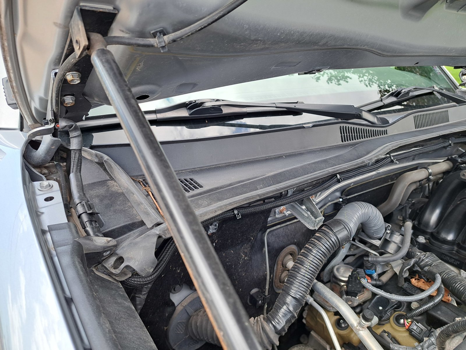

    I'm trying to tidy up my engine bay, and I really dislike the quality/appearance of the wiring for most aftermarket lighting. So for my raptor lights, I stripped all the plastic loom, the nasty sleeving, and the old connections (most didn't even have the rubber stoppers), and I did new sleeving, 16awg where I could, new connectors and new heat shrink. Very pleased with the outcome. All new wiring will go in this way, and I'll probably do what I can with the factory harnesses too.

    Nice work. Maybe also post some before-and-after pics of the old/new harnesses as-installed in the engine bay.

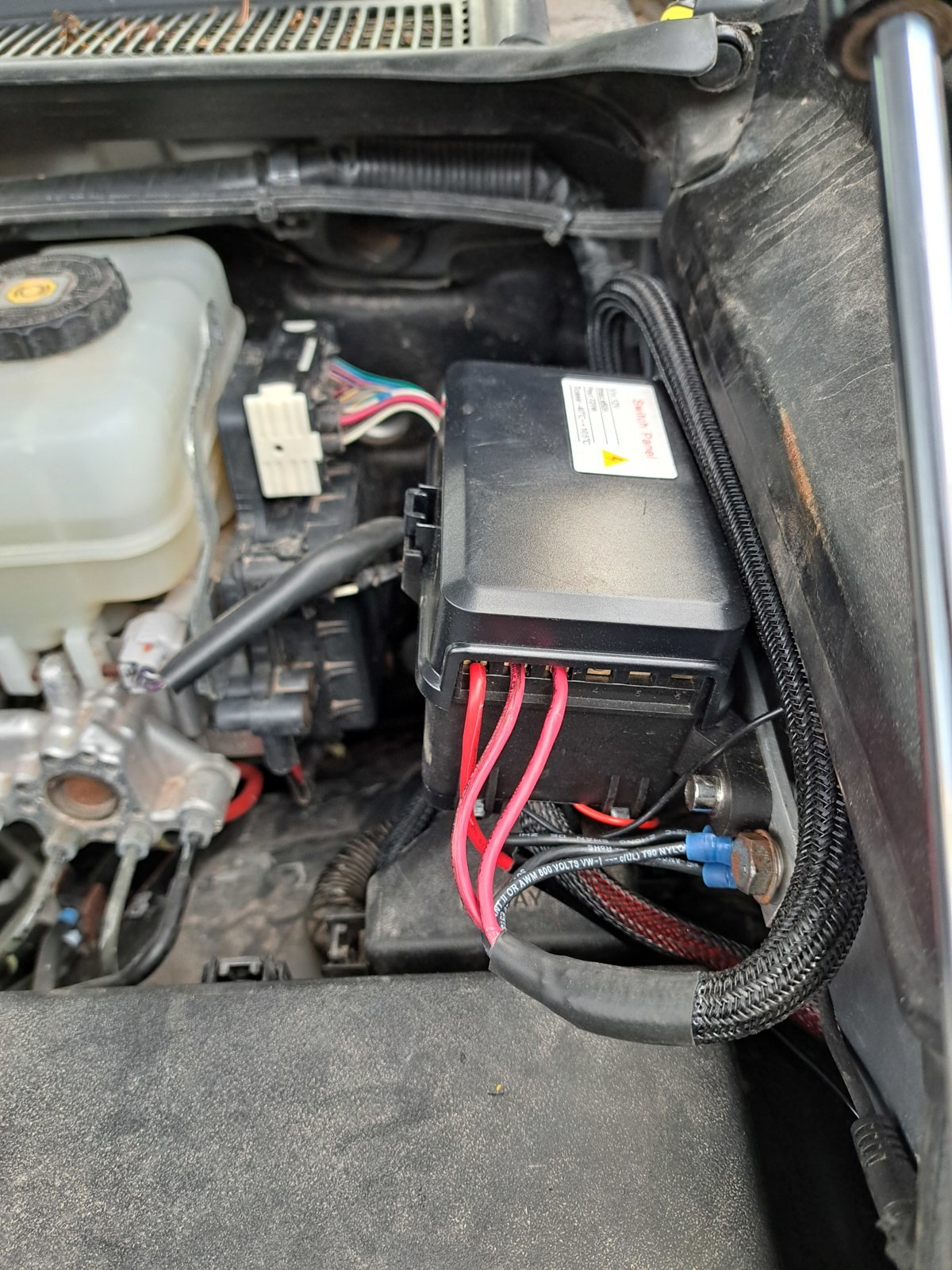

    I absolutely will. I'm waiting on some bus bars so I can have a single connection point for anything that needs the ACC fuse - hopefully only 1 add a fuse in the box. The old harness was basically just split-loom zip tied as out of the way as possible.

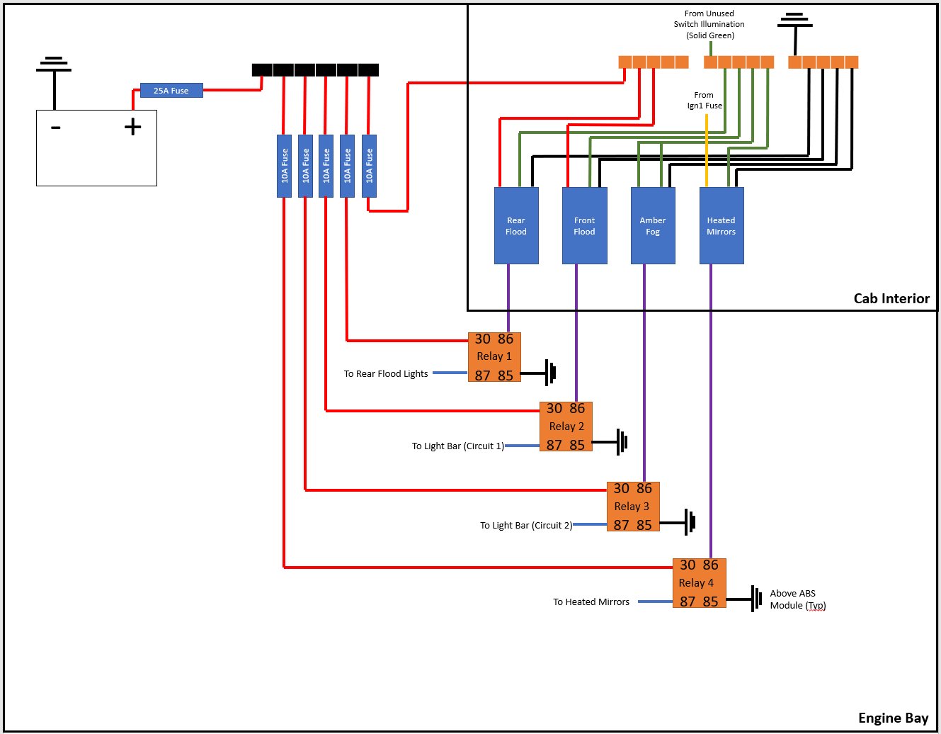

    Yeah it feels good when it's done and clean and you know exactly what's where.
