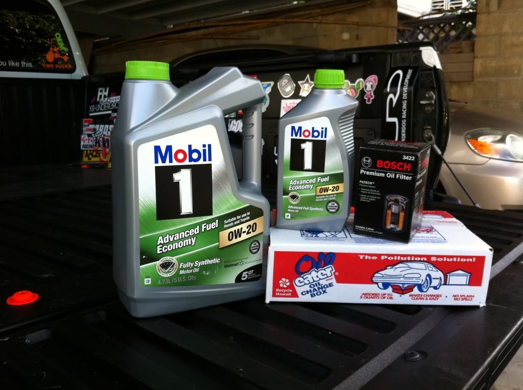

    Put 0w-20 Mobil 1 AFE in my 2.7L yesterday. Will be interested to see if it helps winter MPG's. So far no report from the "butt dyno"
