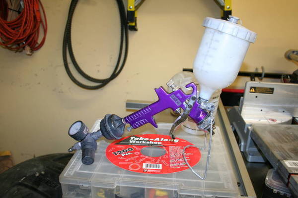

    Get an inline dryer (only about $20) here's mine, its the bubble thing between the regulator and the gun body:
