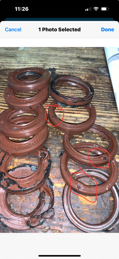

    IMO
    It’s a “while you’re in there” type of thing
    getting seals out
    Few ways
    -crappy seal pick/screw driver(risk dmg to cam and cam carrier while prying)
    -seal puller and press
    Kinda expensive but the best/easiest way to remove and install. I wish this specialized tool was available when I was struggling with multiple seal replacements bc of oil seepage leak
    What I did with success
    -drill small hole in seal….i used a R angle drill to clear confined space
    Then put in gently a small wood screw in the drilled hole on the seal
    Use a angled needle nosed pliers to pry the seal out by clamping on the screw you just put in seal
    The circled seals were removed by wood screw way
    That mutiliated seals on bottom Left were done by mechanic (that gouged my cams so bad I had to RR them bc of oil leaks
