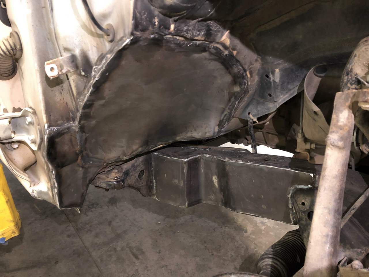

    I did it. Ive got pics of my tub/frame some where on here, but here is one for you.A1976F42-EAAF-4599-81A2-ED6F32F53871.jpg
    Plated the inside, outside and bottom. If I where to do it again I would have just cut out that entire section of frame a welded in a new channel offset to the inside to get the room you would need. You would also need to pay attention to having enough room for exhaust on the inside side of the frame at that point though. Im on 35s and I still barely rub the frame.

    This is awesome! Pretty much exactly what I was looking for. Any issue with frame twisting or breaking? And what thickness is that plate?

    Its been over a year and so far so good. I think I ended up with 1/4" on the inside and bottom and 3/16 on the outside.

    I sometimes forget the obvious the only way your going to be able to do this correct is with the engine out .
    To be able to see and be comfortable welding the inside on such a important weld.
    Much easier to just wait and do your SAS
