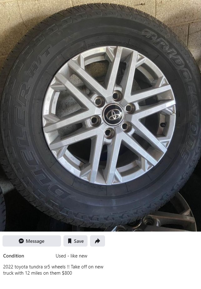

Anyone familiar with these Tundra wheels? Will they fit a 2009 4x4 on stock suspension?

    I just bought a used Tacoma. It needs new wheels & tires. Hoping I can confirm that these will fit comfortably before I buy them.

    2022+ Tundra wheels will NOT work. The hub bore is smaller vs Tacoma hub bore.
    Look for take off Tacoma/4Runner wheels if you want to go that route.

    If you don't mind me asking, what would indicate that they do not fit? Where can I find the "hub bore" for a set of wheels?
    I don't know much about vehicles, but I thought they'd fit because my stock taco wheels = 6x139.7, and these wheels are also 6x139.7.

    @JonSullenMelancholy the center bore (hole in the back center of the wheel) is smaller on a 2022 Tundra @ 95.10mm than on a 2009 Tacoma @ 106.00mm the wheel would not fit over the center hub of the vehicle.

    @JonSullenMelancholy If you prefer the nicer and bigger 18"/19" diameter wheels, look into take off Lexus GX460 OEM wheels. All GX470/460 wheels will be a direct fit on your 2009 Tacoma.
