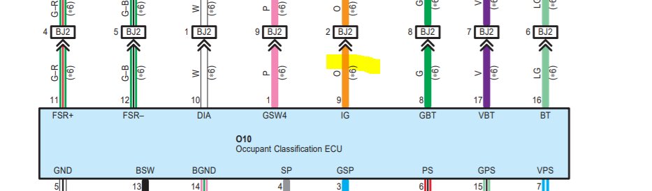

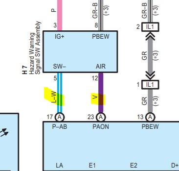

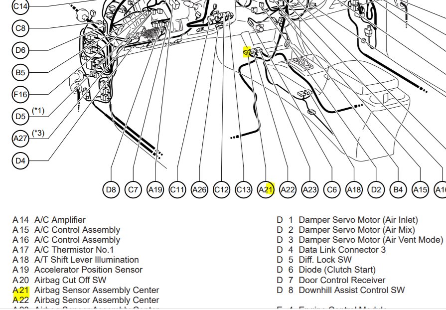

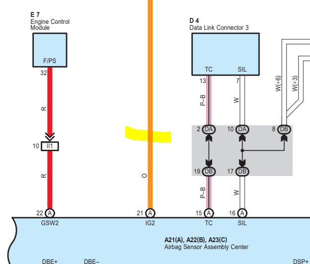

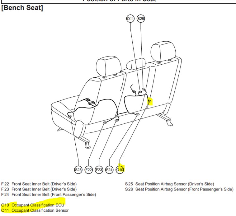

    Well that is just a SPST, you'll need to wire up a relay to divorce all the power sources to the ECU. If you are set on that switch, I'd wire each source through the NC contacts of a multi pole relay, this way if the coil burns up it'll fail to the safe state of airbags on. I attached the full schematic of the SRS system in the thread here.
    Wire two of the contacts between these wires here at the Airbag Sensor Assembly Center at connector A21 pins 17, 21, and 23.
    4th pole will disconnect power from the Occupant Classification ECU
