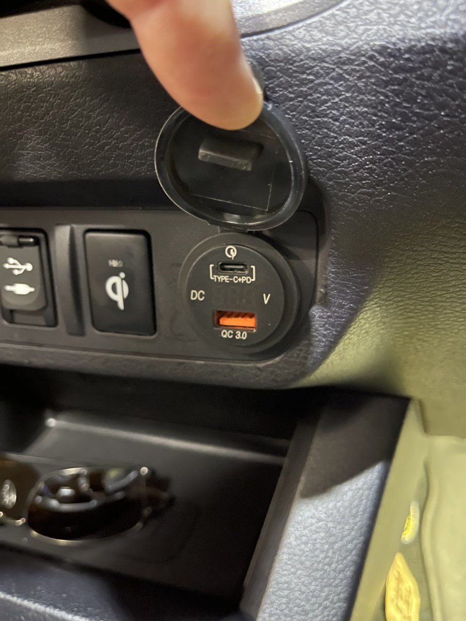

    I used the existing lighter port. I took my Dremel with sanding wheel and slightly enlarged the hole of the original lighter insert. I split the connector for the original lighter and plugged it straight into the new USB device.

    Looks great. thanks for the pic. I'm hoping to find one to replace the USB that controls the stereo as well. I never use the AUX and would love it if it was a USB C that would interface with the stereo.

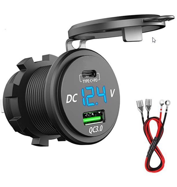

    Has anyone charged a laptop using these? I’ve seen people saying they charge your phone fine but not the laptop. I want to put one in my RV.

    To keep things flush and nice looking, instead having something like you listed sticking out. And the replacement 12v dual usb socket will have a cover and volt meter built in which is nice as well.
