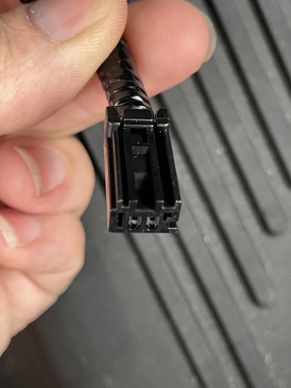

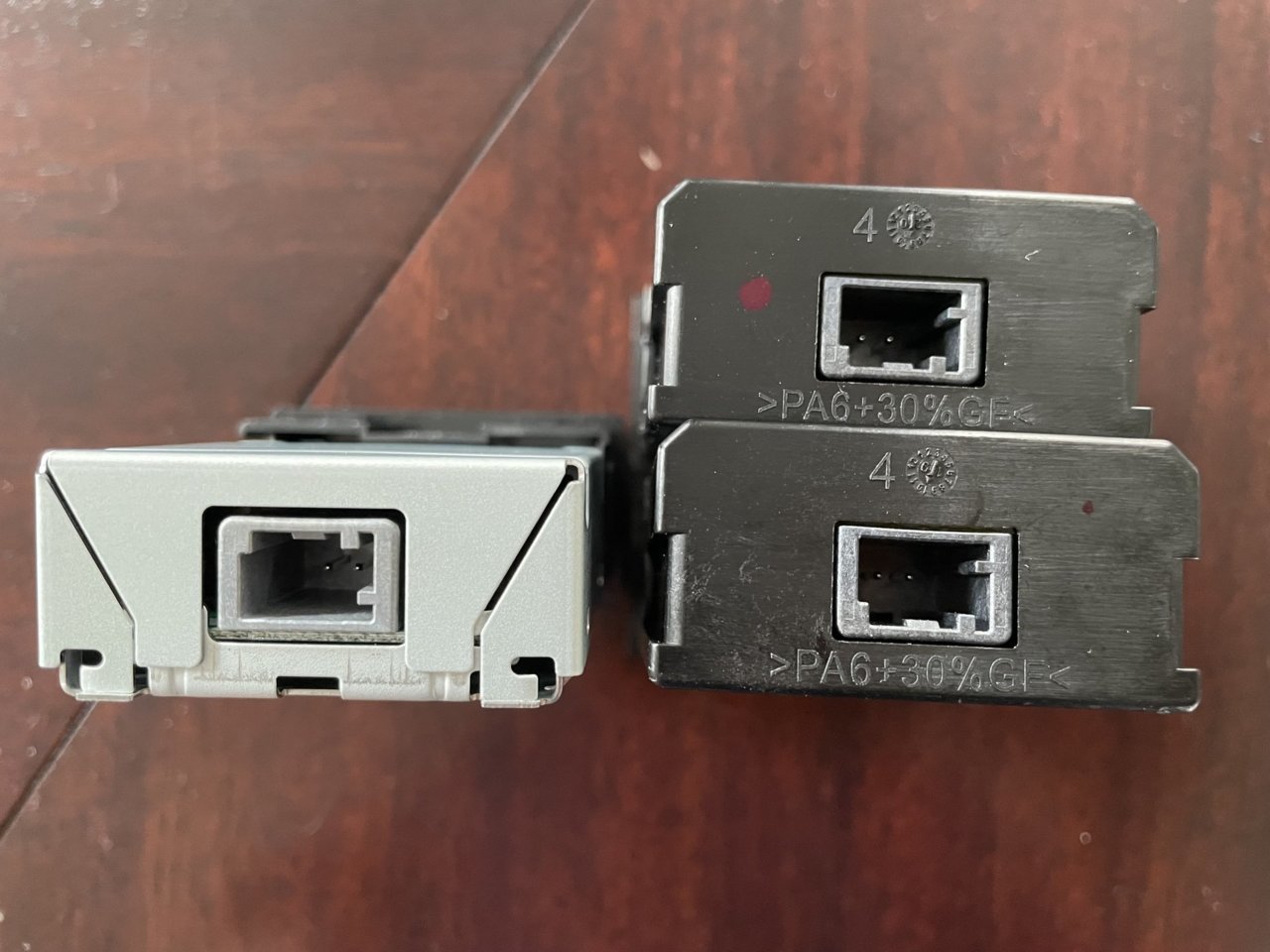

    Here are some pics of the rear side and the connector I found from the RAV4 forums.

    You could buy the connector itself.
    @caribe makaira even listed the part number for both the connector and pins. Then connect it to a 12v circuit.

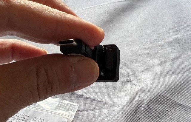

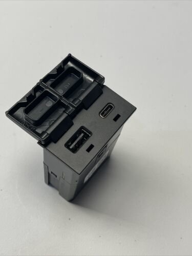

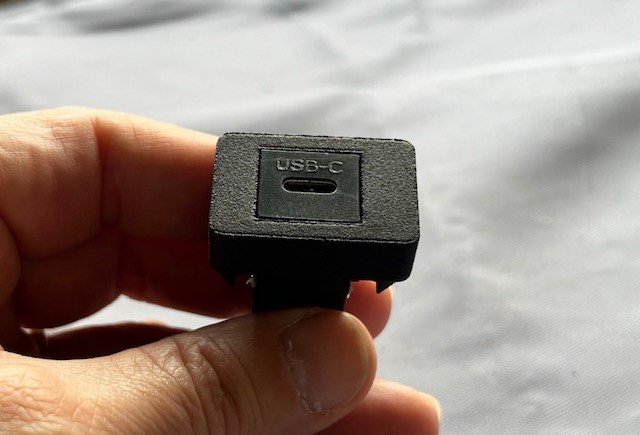

    I was not a member until today and the only reason I joined was to say thank you. Your post was dead on and answered the real question that was missed by many. I think the person asking knows how to plug a USB charger into a cigarette lighter port, but they clearly wanted both charging AND DATA. The problem is many Apple CarPlay and Android Auto stereos have USC-C ports on the back and it looks like crap to just have that wire hanging out the dash. It would look much better to have a more OEM look and I don't want to adapt it back to USB-A inside the dash. For some reason manufactures have not got with the times to make a USB-C (data and charging port) that fits into a stock blank. Options are available if you would like to cut into your dash, but nothing that fits into an OEM blank for USB-C.
    See attached photos of a USB-C data/charging port I just installed in my 2018 Tundra thanks to this post. Thank you again!
