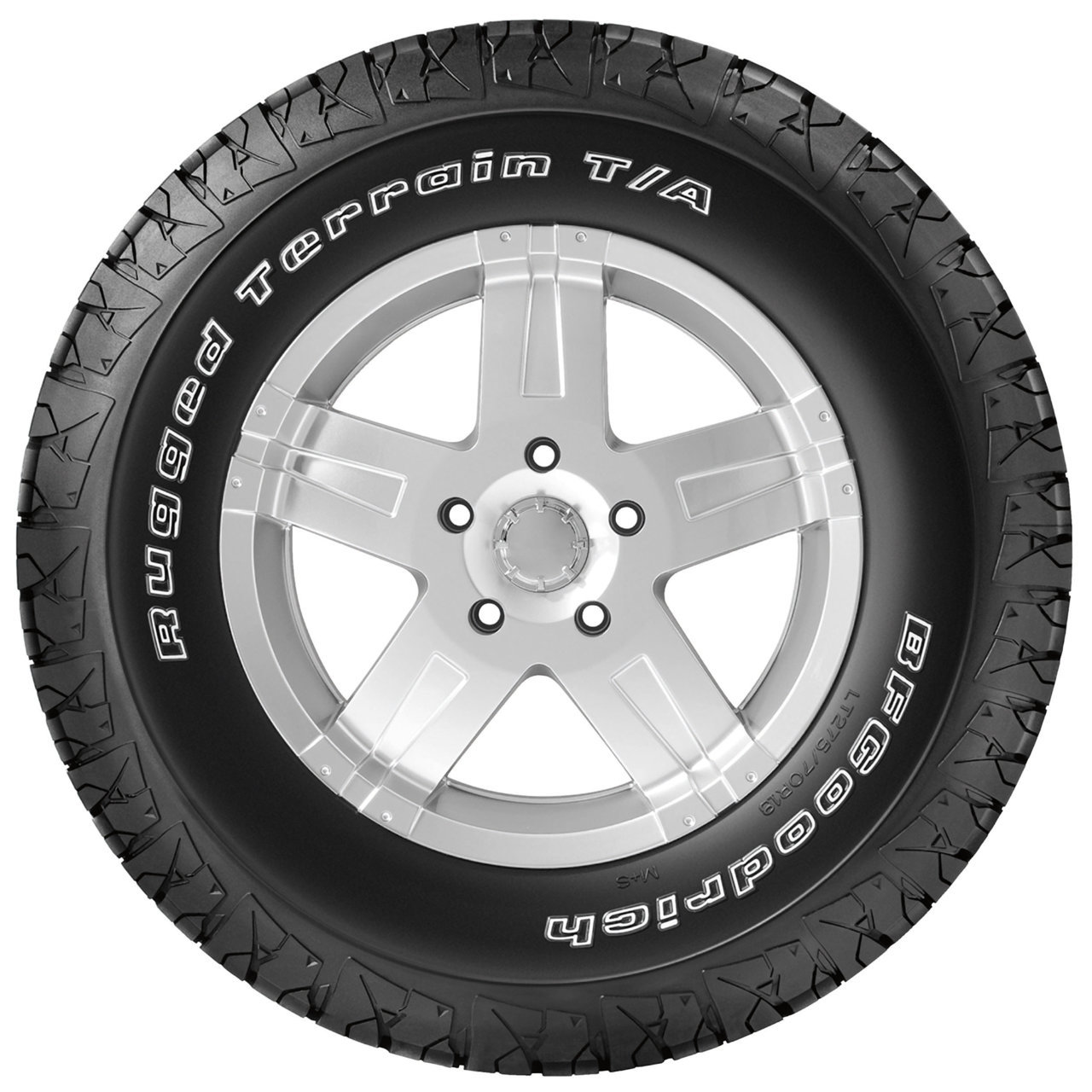

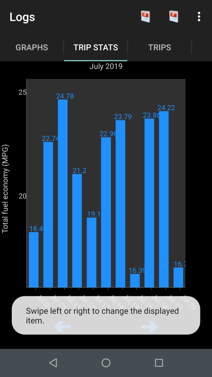

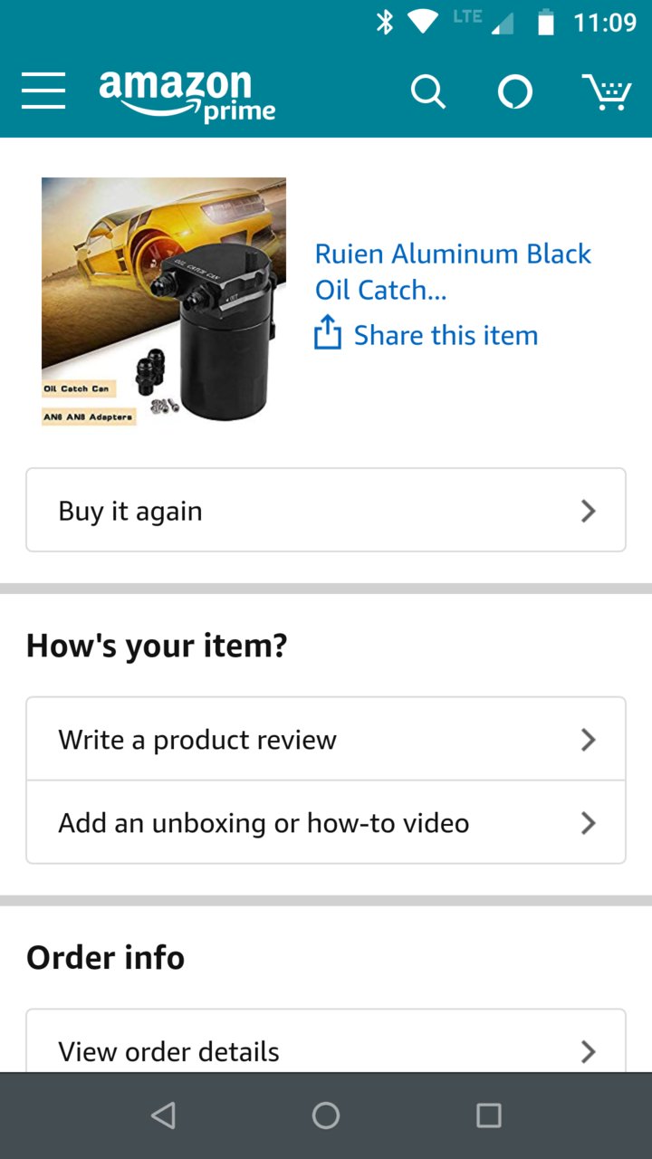

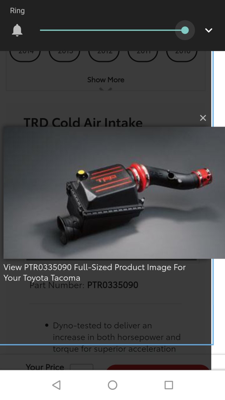

    Mass Air Intake. Replaced blown alternator and power fuses: 2 fuses.
    2005 Toyota Tacoma Access Cab PreRunner V6: MPG = Highway, easily 24 to 25; Street only: 16 to 18 easily. Again, this is based on the following adjustments/changes:
    1. Changed the air intake: Installed Toyota Cold Air Intake: PTR0335090. 2. Oil Catch Can: Installed to recycle the residue/left over from PCV valve. 3. Tire Air Pressure: Maintain correct/safe tire air pressure. 4. Fuel: 87 Octane (The cheapest @ pump here in Los Angeles, CA). 5.) Engine Oil: Full Synthetic.
    NOTES: 1. Toyota Cold Air Intake: PTR0335090: Please check prices online; your local dealer's prices are higher than online prices; especial here in southern California. I bought from a Toyota Dealer away from my local area. Actually, I bought from a toyota dealer from Ohio state (California Dealers charge about $100 to $250 for this item.) 2. Oil Catch Can: Residue/Oil, water, fuel mixture is collected and prevents from return to the air/fuel mixture. Prevents this bad residue from returning to the engine. 3. Tire Air Pressure: (My tires: BF Goodrich Rugged Terrain T/A P265/70R16 111T). I follow the maximum air pressured allowed based on the tire walls, not the recommended air pressure on the stock tires based on the door tag. During the summer, from the maximum allowed, I lower the pressure a bit, about 2 to 3 PSI to compensate for the high high temperatures/high heat in southern California. I heard that high temperatures increase the air pressure in the tire and make the tire more prone to blow outs/flat tires. Follow safe air pressure: Under-pressured tires create rolling resistance. When the right time arrived to change the (Original tires from the dealer) worn out tires, I replaced them with BF Goodrich AT (Please correct me if I am giving your the wrong tire name here. The safe, correct air pressure applies to all tires regardless of the brand of choice. I do my best in having my tires close to the maximum allowed air pressure. The less rolling resistance, the higher MPG (Sorry everyone, just mentioning it, I know most of us know this). Time and degradation: Time to get a new set of tires and a new spare: On the 5th year, a tire needs replacement whether they have been driven to their maximum thread wear or not since the rubber degrades over time. https://www.edmunds.com/car-maintenance/how-old-and-dangerous-are-your-tires.html NOTE: I have also provided a graph with my MPG for a few days: The graph shows the MPG for both city and highway/freeway driving. Unfortunately, the software/app I use with my OBDII device does not breakdown or separate the city and highway MPGs. The MPG under 20 MPG is for city driving only with consistent stop and go. The MPG with higher than 20 MPGs is for combined city and highway driving for that day. I have observed in the past when I tracked my highway/freeway driving that my MPGs increaged from 24.5 to over 25 for highway-only driving. Unfortunately, my software/app does not isolate/sort out city and highway driving. I am confident that my highway MPG is very high. Room for improvement: I need to do my online research on the apps/software for my OBDII device to track my MPG or possibly get a newer OBDII device with a better app/software to track separate city and highway MPGs within the same day. I hope my fellow readers find the information above help. These are my personal modifications to my 2005 Toyota Tacoma Access Cab V6 Prerunner. Cheers every one !!!

    Thanks for sharing, and nice to atleast have some evidence of your mileage claims. I think some members have posted data that was either miscalculated, or taken from short, unrepresentative snapshots.
    It will be interesting to see if your fuel saving costs will offset your tire wear costs. You will wear the center of your tire tread rapidly running higher than the Toyota recommended pressure.
    The COI I find interesting. I monitor the intake air temperature via scangauge and find it to be at least 10 degrees F or more higher than ambient temperatures even on highways, idling can be much higher. Does your monitoring system allow you to measure that? Does the coi use the same airfilter as the standard stock?
