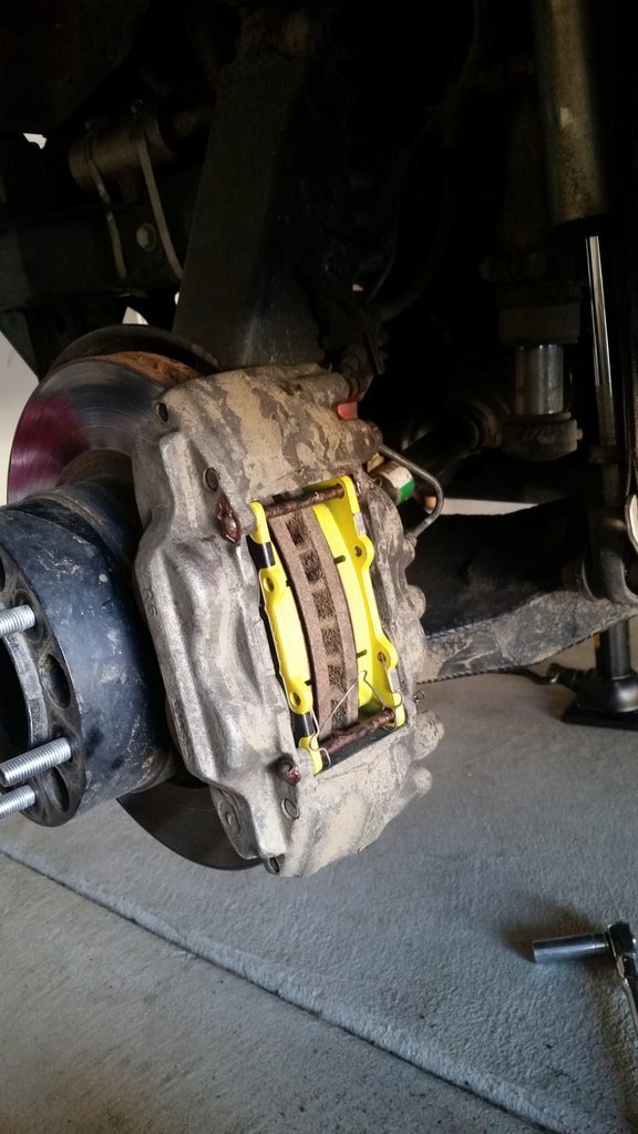

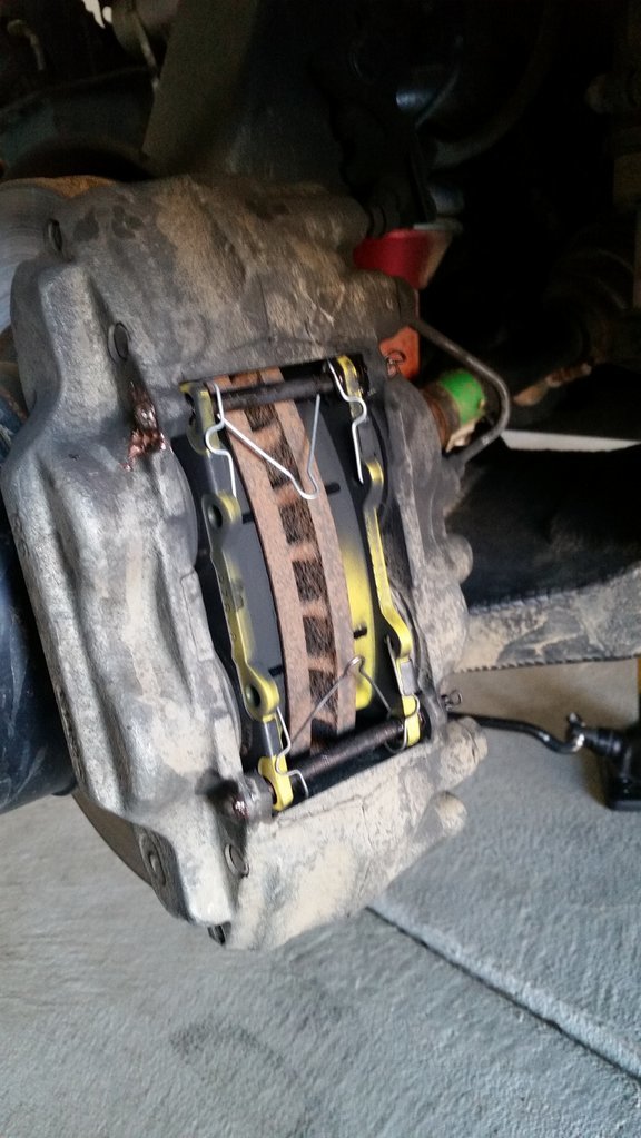

    I did all this what u have done with new caliper pins and mine eventually came back to clack again, have gotten used to the clack cause it does no harm to the braking system just a very slight annoyance

    Sometimes the pad is not worn out. It’s just shifting forward and back. It’s really more of a design flaw.
