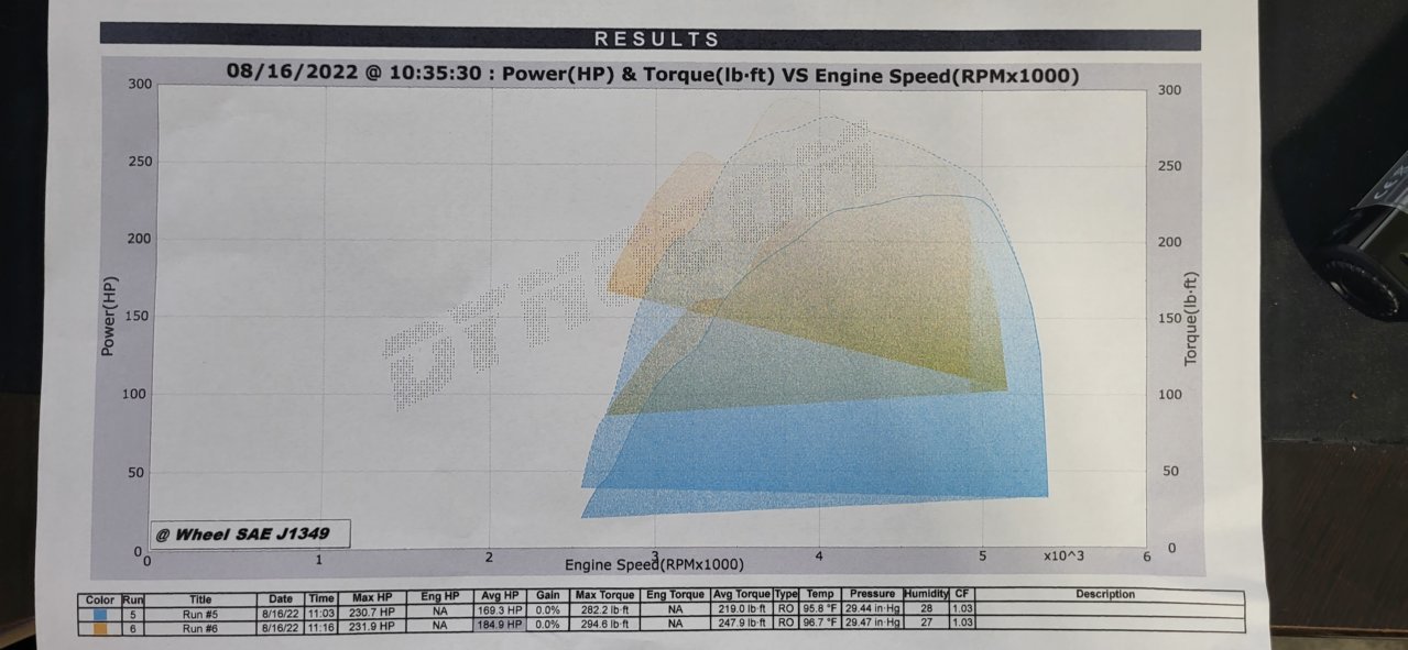

    Got the results back 231.9HP, 294lb ft of torque, anyone have any idea why my HP is so low? Would them not turning off traction control effect the numbers? 20220816_133412.jpg

    Honestly it sounds like a calibration issue with the dyno. Again I would get this re-evaluated somewhere else where they can give you some useful information like AFR and Map values.

    Calling around now, thanks for the advice, anyone know expected gains from aftermarket tuning after using the Procharger factory tune? I imagine procharger runs it super rich and change the timing to make it safer

    What's your elevation?

    Seemed like most people on the stock tune/setup were making around like 300hp/330tq. Like I said before it was discovered that their tune was pretty crummy so I wouldn't make any assumptions. I also wouldn't rip on it too much unless you got a wideband in there, and or a dyno with AFR to make sure everything is safe for ripping. You don't want to melt a piston or something because it's super lean and you didn't know. Did you use the fuel pump booster or install an aftermarket pump?

    I used the provided ProCharger fuel pump booster and injectors

    What was used for tuning?

    The Procharger tune that came with it

    With the HPTuners RTD device right?

    Yep, tuning shops should be able to adjust it since it was flashed with HP tuners software right?

    They could with a full HPTuner not the RTD, you would also still have to buy tuning credits. On the note of the RTD device, you can use that device to data log with the VCM Scanner software. It's a free download, you should make a log and post it up.

    Couple minutes cruising, one soft accel normal driving, and one hard one should be plenty.
