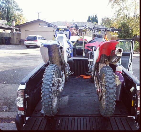

    Had both bikes towards the outer edges of the bed and the bars overlap maybe just a couple inches.

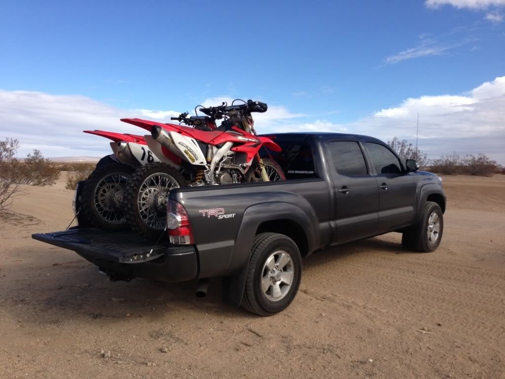

    Pretty easy to fit a couple bikes in the back of one of these trucks.

    i still dont get how you guys get the bike so close to the sides... when i tie mine off like that it tips to the opposite side of the side thats tied close to the edge. there's not enough angle to support it. I end up having to use another tie down to wrap around the frame and tie off to the side of the bed.
    also, these are all longer beds. on a 5 foot bed, the wheel sticks off the tailgate.

    I agree. Mine are towards the outsides of the bed but I keep them centered enough to get good angles on the tie downs. I cringe when i look in the rear view while cornering and see slack in the tie downs.

    I just slide my footpegs under the side rail and tighten my straps down good and have no problem with them staying in place while driving. I have a moto bar too, it holds my front tire and allows me better tie down mounting locations.

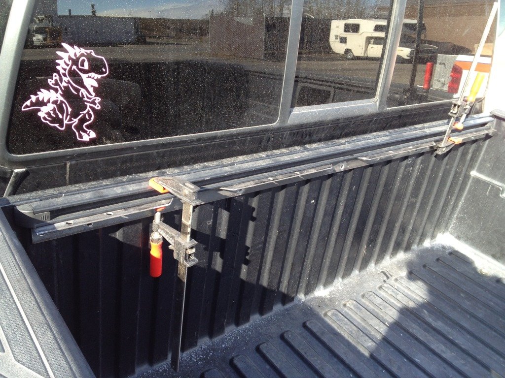

    I have the same problem with putting them far apart. Seems that you really have to tighten the outside straps to get them to not get the slack.
    I did recently pick up some of the JP Metal Fabrication Reinforcements for the front corners. http://www.jpmetalfab.com/products.html
    Great improvement over the plastic d rings.

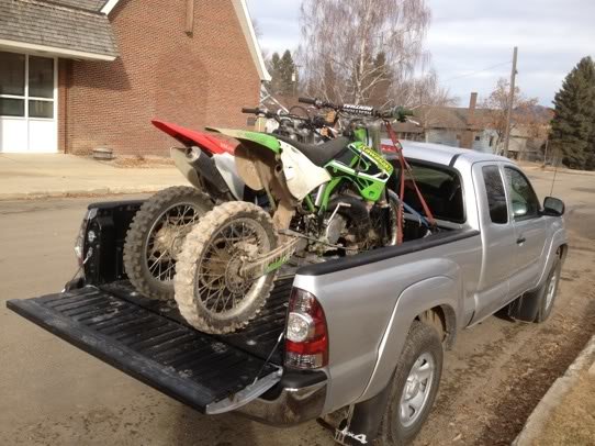

    Very easy to fit 2 bikes in the back, just have to let the gate down unfortunately. With one bike, you can put it in there sideways and the gate will close, that is what I did with mine anyway.
    various-pics-i-took-over-xmas-break-kate_7ba0791cd19dd2649e3180e4bbb7f2faf8d0c667.jpg
    I traded my Honda in last fall for a quad though, 400ex and it fits in the back with the gate up.

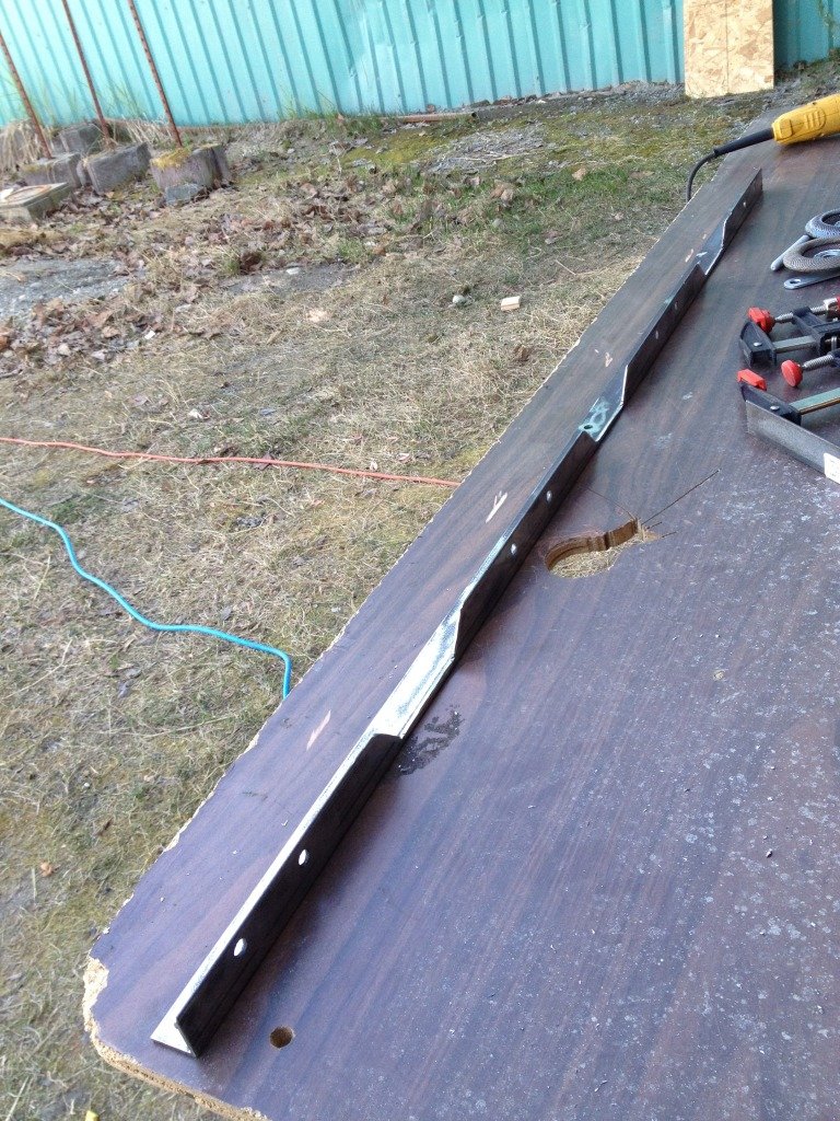

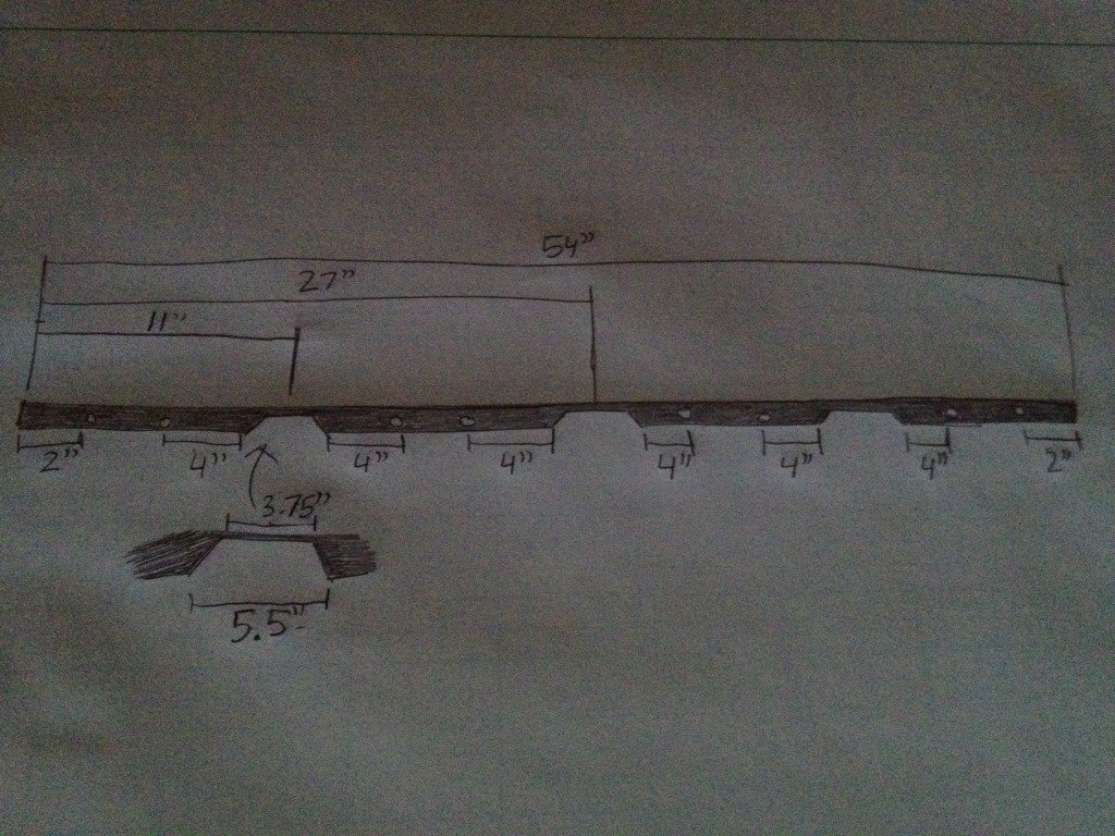

    Made my own mount. Was about $70 total.... $50 was for the powder coating which i should have looked around for a better deal on.....
    sorry, no pics of it with any bikes :(

    so how did it work out? would you cut those out in the exact spots again or would you move the outer ones in or out a bit??
