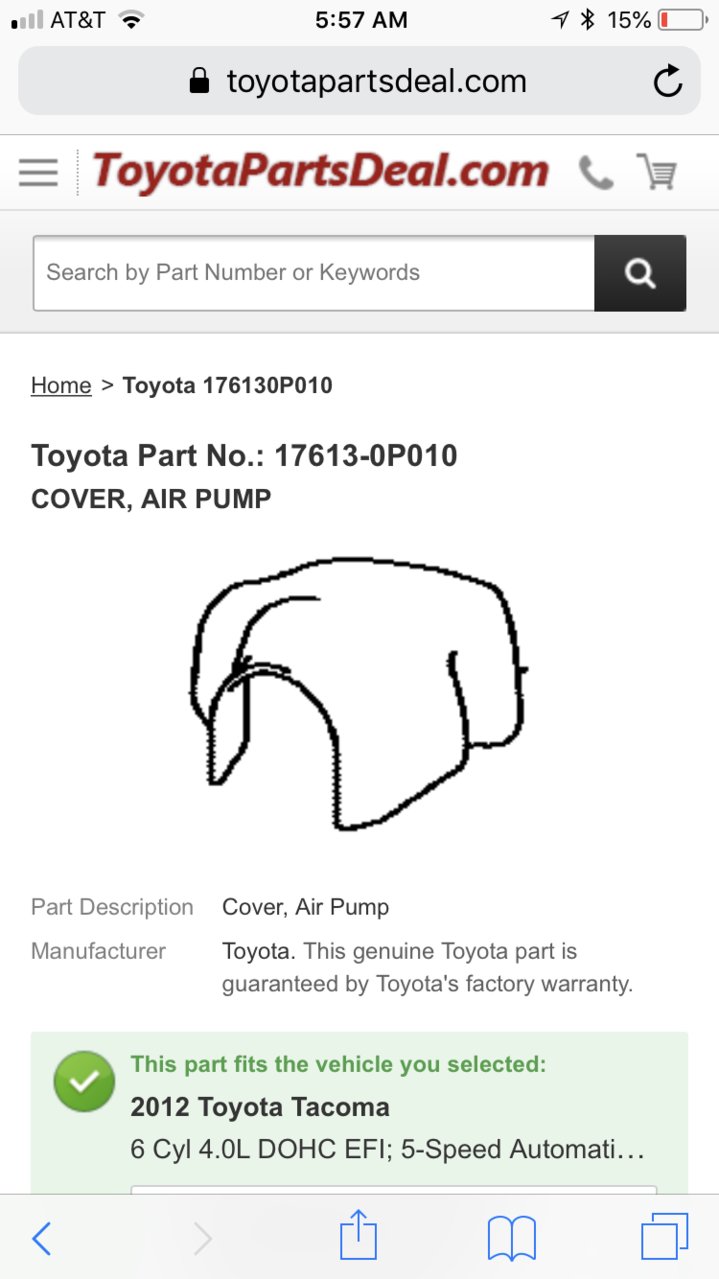

    No worries. I don’t know if it helps anything, but it looks better, covers the uni-filter and is a lot quieter at startup.

    Just want it for the peace of mind honestly. I didn't realize it also makes it a little quieter too which is a bonus.

    Yep. There is some foam on the underneath side of the cover that acts like a sound-deadening material. Definitely made a difference in the high pitched whine at start up.

    Be prepared, install takes every bit of 3 seconds.
