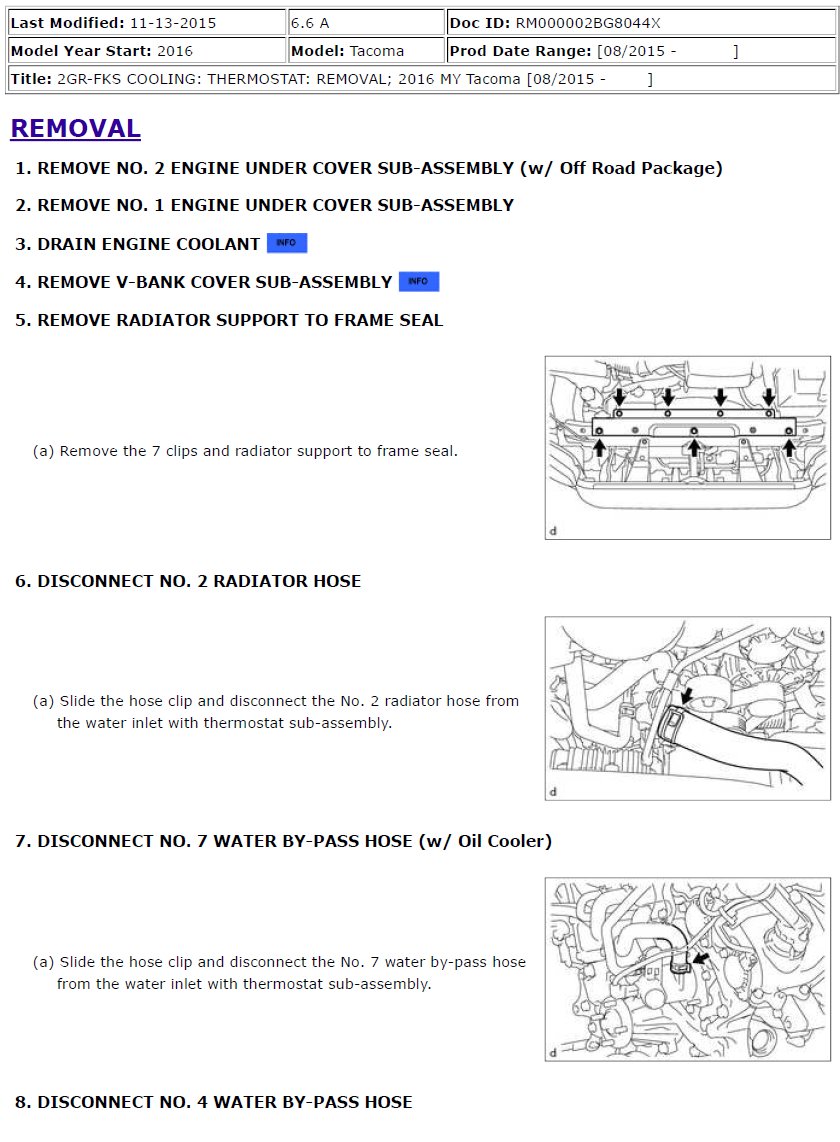

    I'm at a bit of a loss with why my 2017 TRD Off Road Tacoma, had engine and "Trac" light come on and noticed engine temp never really climbed off low... But its been -20.. Anyway, got the code read and turns out thermostat is gone.... And I can't find any info about thermostat replacement on the 3rd Gen Tacoma. Just off warranty with only 60k kilometres and it failed... Not sure if this is a common occurrence even! Anyone dealt with this on theirs yet?

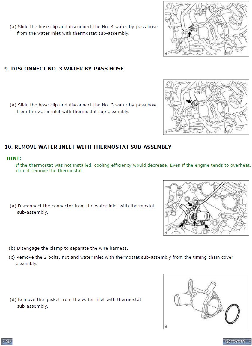

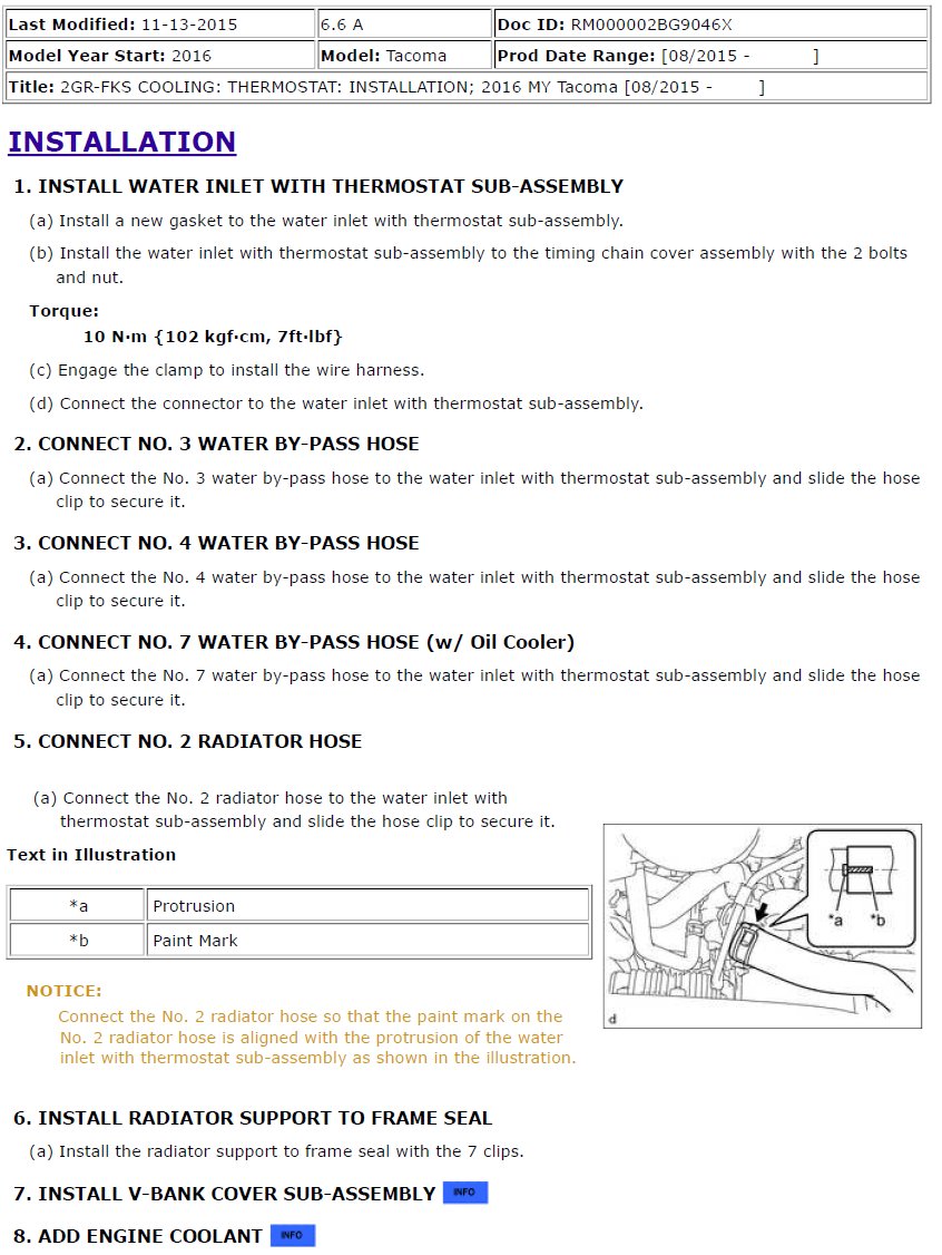

    A few pages from the Service Manual:
    https://drive.google.com/file/d/1cx5nnlnCzlhI45D1vbBMj1ni983SKdKf/view?usp=sharing
