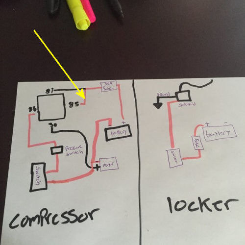

    Ok so here's a crappy diagram for wiring my compressor, and th locker, look good?? image.jpg

    Looks good but, add a small fuse to protect the smaller gauge branch circuit wiring at the yellow arrow below. Do this as close to the tap, splice, or 12v source you use for control.

    Ok that line is only a few inches inside the compressor. Only reason I'm mounting it is because I'm using it for my locker. I'm using a viair 6 hole manifold
