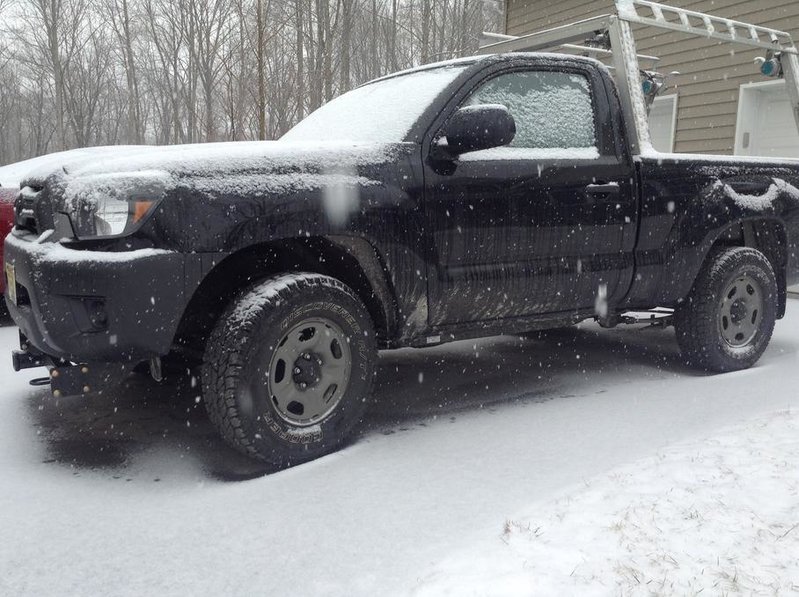

    Here's what 1.75" looks like with 30x9.5-15 tires.

    Thanks Navin I love that custom fab you did.
    I found some spacers on eBay that claim to give a 2" made in Irvine, Ca by Custom Tech. I can't find anyone that has it on their truck.
