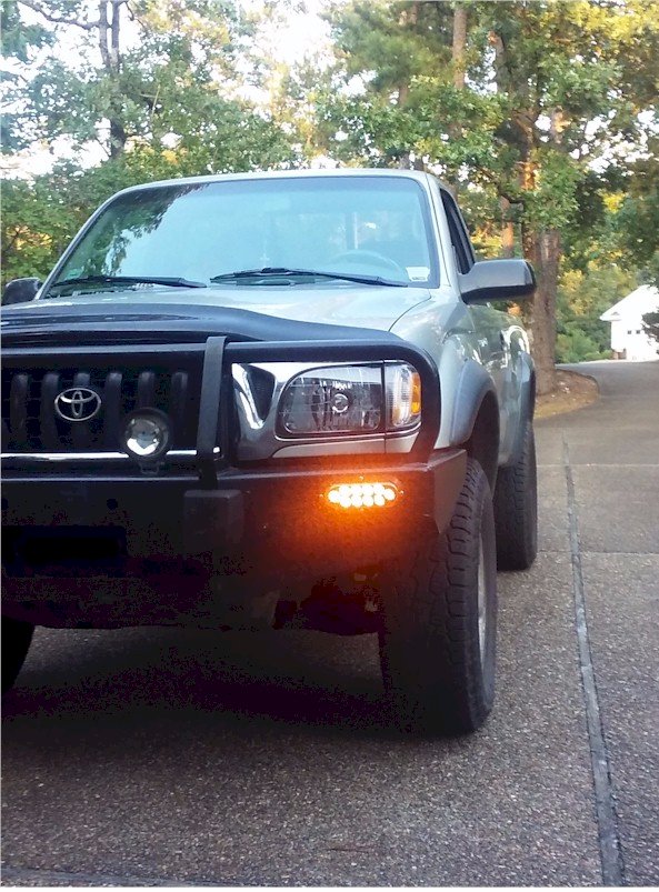

    Do mean on an older ARB bumper like this?
    If so, I do. I just replaced mine with LEDs.
    I can send one or both for cost of postage.

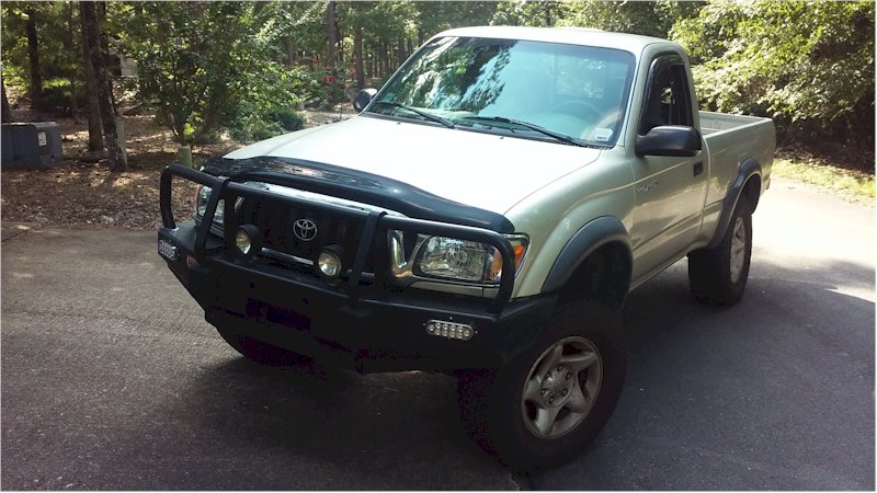

    2strokerush,
    I sent off the old signal lights from my ARB
    Post Office said you should have them by Friday.
    FYI these LEDs is is what I replaced them with.
