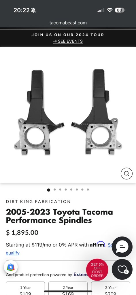

    Does anyone have a Dirt King spindle? I just bent my OEM Spindle and I’m looking to upgrade, but I haven’t seen pretty much any videos or people’s review on them. Just trying to get an idea before I buy them.

    I was in your boat a few weeks ago. Those got great reviews but the price was way too high for me. I found a pre-owned replacement spindle for less than $200 and then got some Total Chaos gussets and had them welded on for a few hundred more. Got my cam tabs replaced with beefier ones at the same time too. All done for less than half of those.

    For that price hell no man. Do what @shaggy135 suggested and spend the left over money for other gussets and welding services. For the same money you can do all that and coil bucket gussets.
    I'd also suggest buying directly from the fabricator when possible instead of through a middle-man like TacomaBeast.
