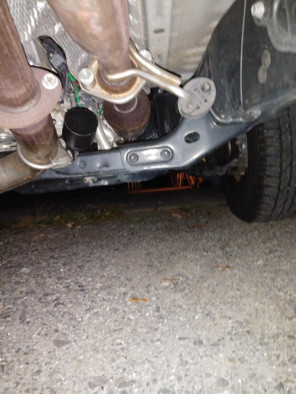

    I cant find the part number or the tread but its on here sonewhere..i just did this and it worked..im about to buy 2 more and make this thing lexus smooth...its a damper used on other toyota and lexus models ...thanI god i camr across that thread..wish i coukd find it and give you guys the part number but ask toyota and match it uo with this pic and you'll be happy 20211020_185148.jpg

    Its about 55 bucks

    I want to say sienna or highlander?

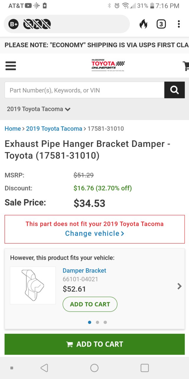

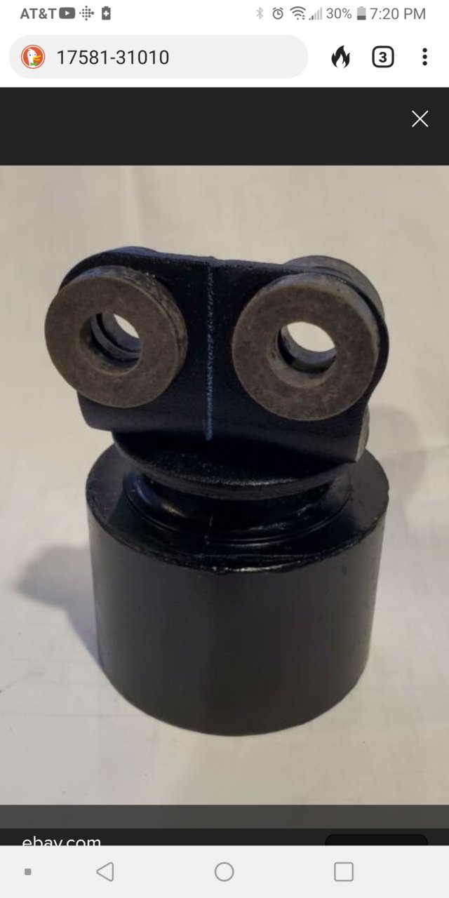

    Screenshot_20211020-192040.jpg Screenshot_20211020-191605.jpg Screenshot_20211020-191605.jpg
    I believe this is it .my dumbass threw the packaging away but this has to be it .aa you can see in my.first pic it has two holes at the end that acrew onto the highlanders or siennas exhaust bc their exhaust has a bracket welded on it..i just used a hanger from autozone through one of the holes and it worked fine for me .hope this helps someone .
