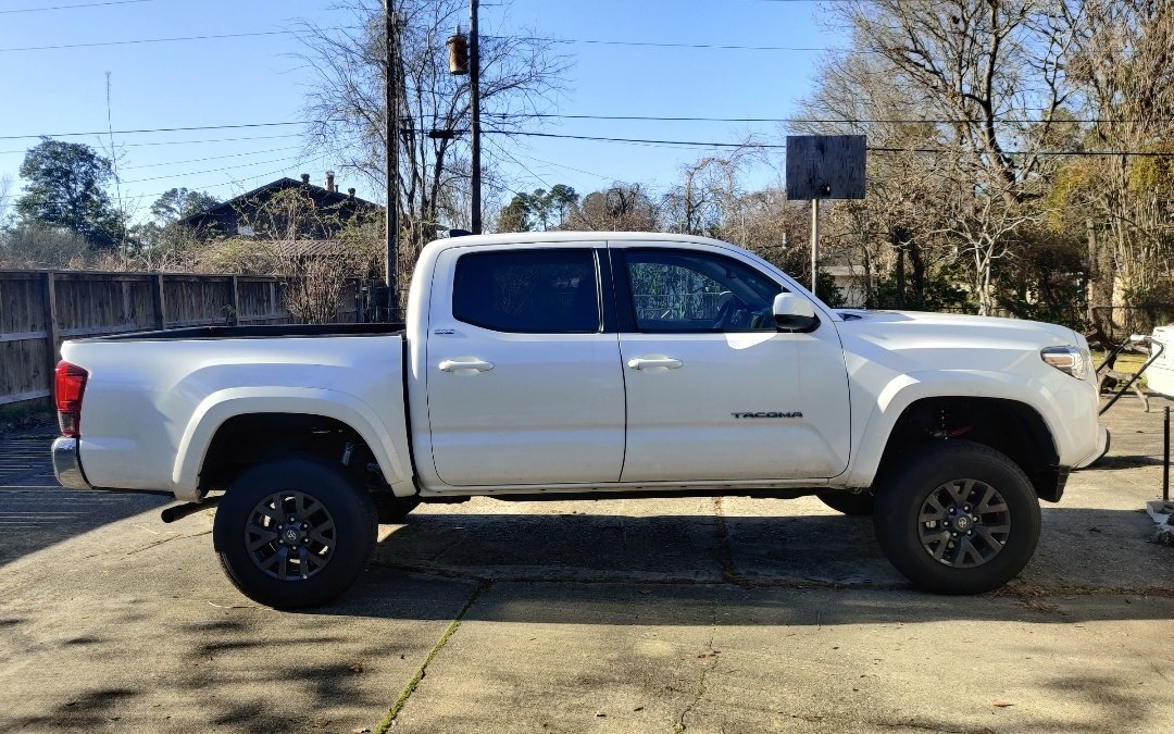

    Icon Rebounds 17x8.5 Toyo 35/12.5/17 JBA UCA, Bilstein 6112/5160, KDMax
    I had my lift done first. 6/5 1/4" top plate both sides, 1.5" rear block. 6112/5160
    2wd, non-OR wheels.

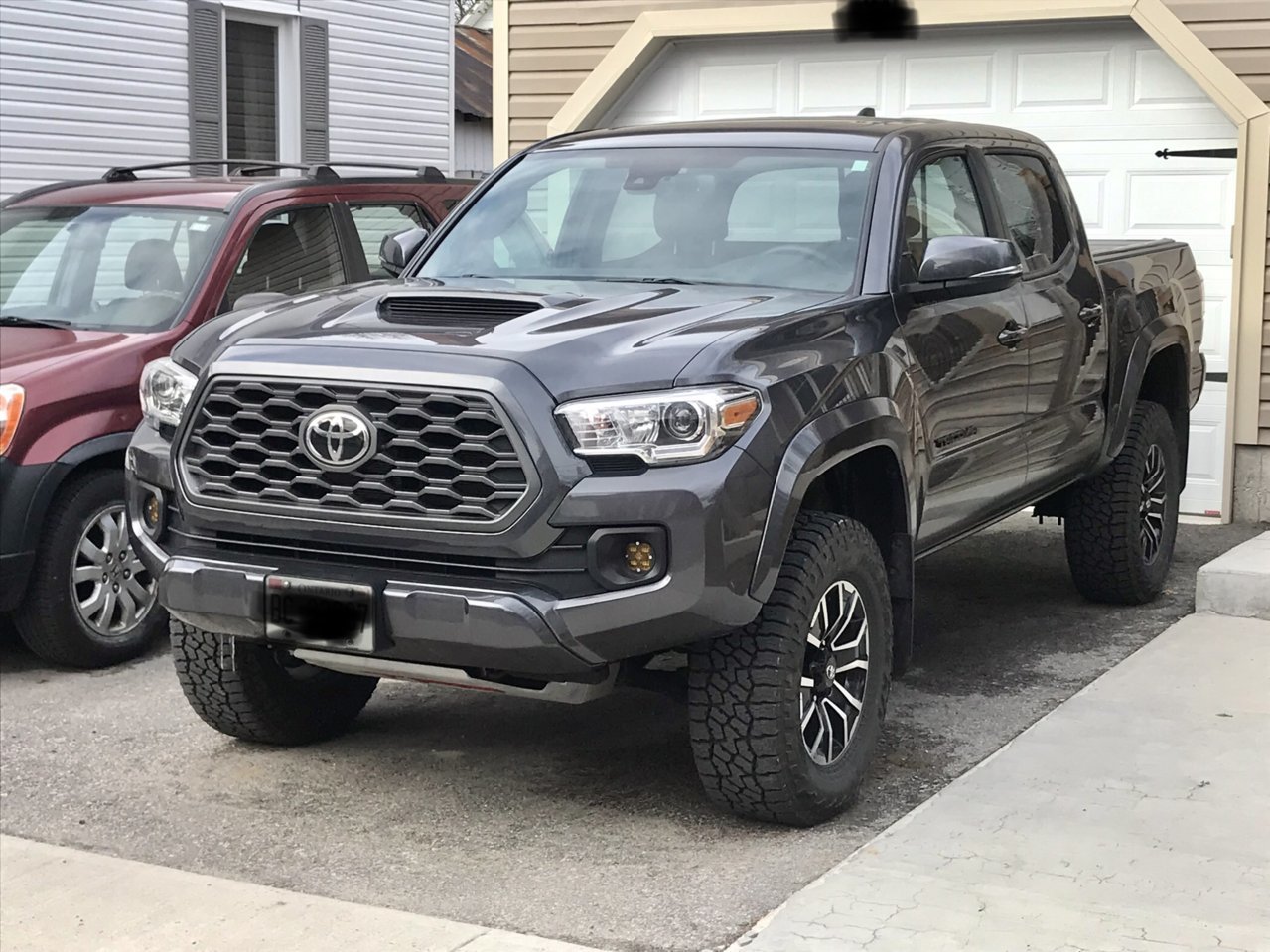

    2 gen pro suspension kit (6112/5160) and icon RXT option 2. It’s about 2" all around. 17" sport wheels

    Wow. That looks much better than I expected it too.
    Can you add some details on what the Icon RXT option 2 is? Is that the leaf pack or springs or?

    Looks good! Did you do the lift block instead of an add a leaf in back?

    It’s the full leaf pack. As per icon’s website:
    Basically you get the leaf pack with an extra leaf that you can either swap for one that’s in the pack (option 2) or add into the pack (option 3). Option 1 being installing the pack as it comes. I’ve had mine on for about 10k KMs/ 6 Ish months and it’s been excellent.
    keep in mind that ride height will change as you add or remove weight in the bed (obviously) for me I have about 100-200# of constant weight in the back so option 2 made sense for me.
