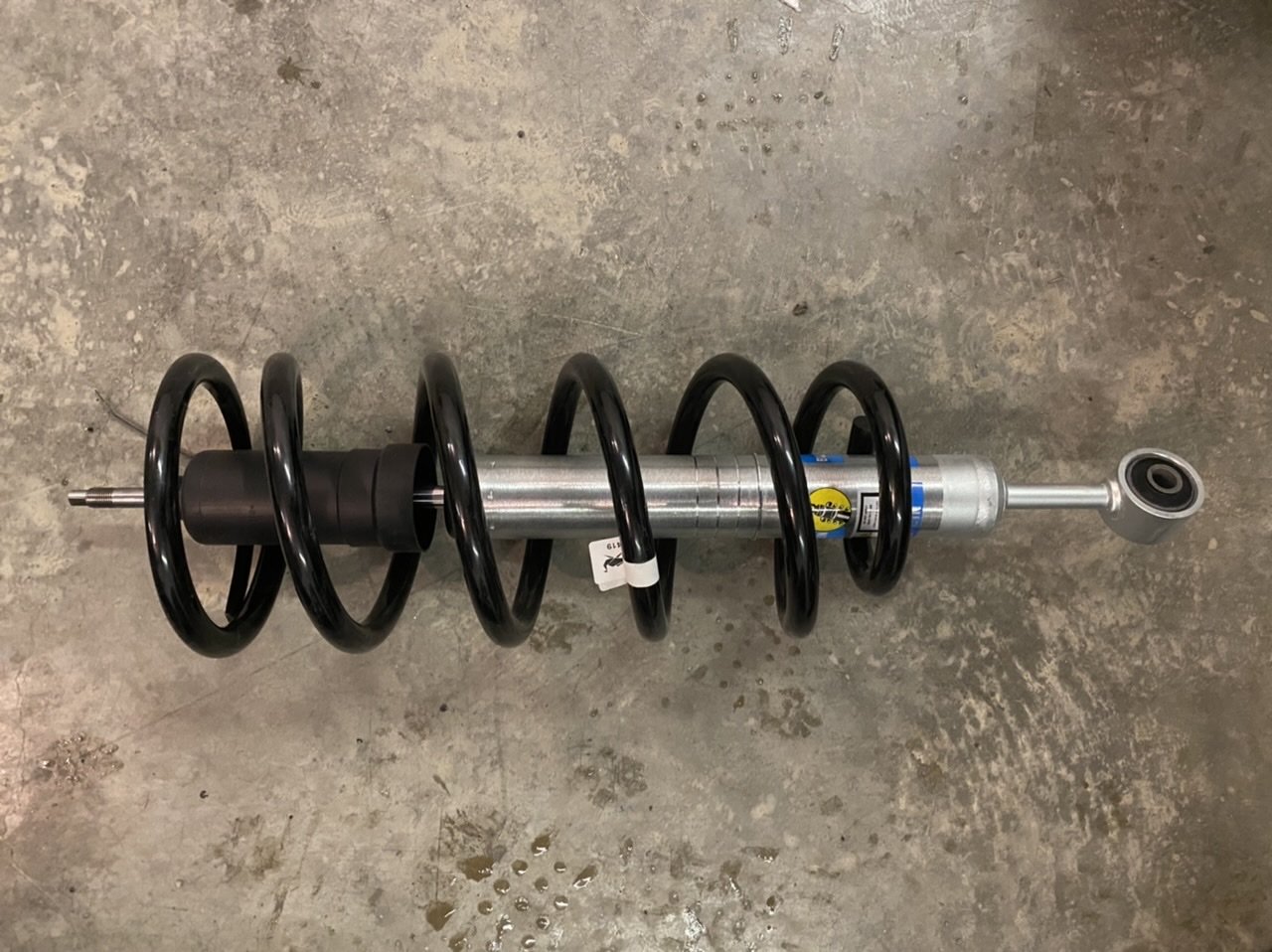

    I have searched high and low for an actual photo, with no results.. which is why I am asking the question..
    Anyone have a picture of an OME 886x mounted onto a Bilstein 5100?
    Got my springs in from tdotperformance, and I’m thinking they’re not the right ones. Am I missing a part of the install process?
    Any help and feedback would be appreciated.

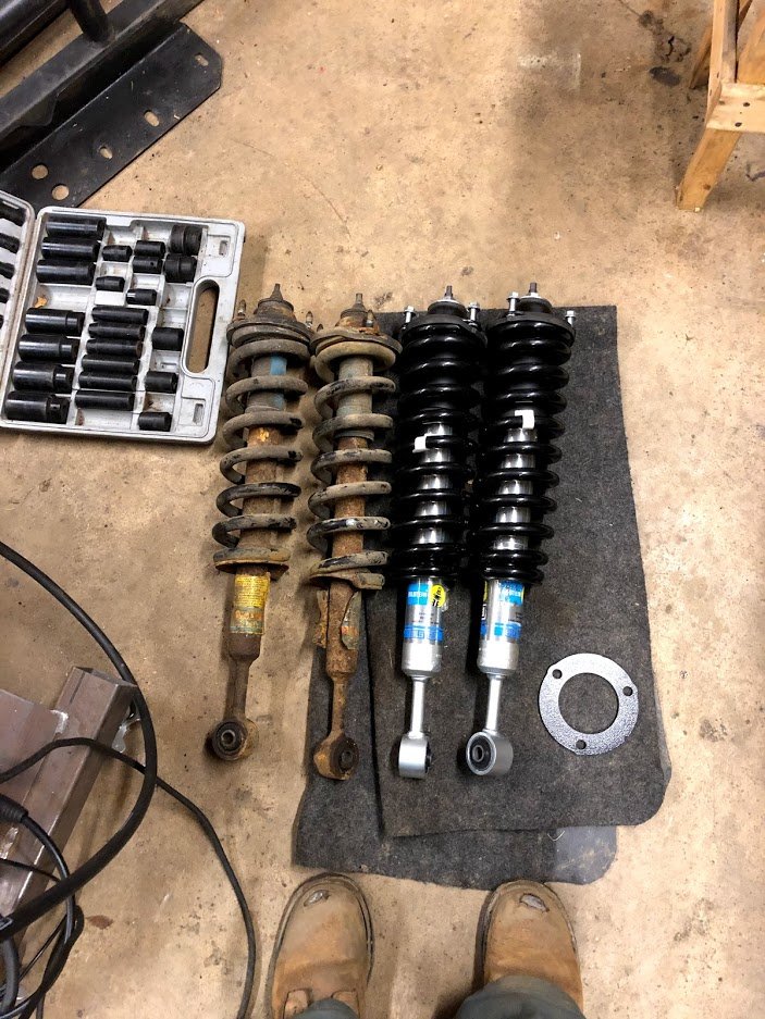

    ask and ye shall receive.....
    Pictures are fresh...... taken between Dec 20th - Jan 4th.
    installed my lift during Christmas Vacation. Ome 886's on 5100's along with some other goodies

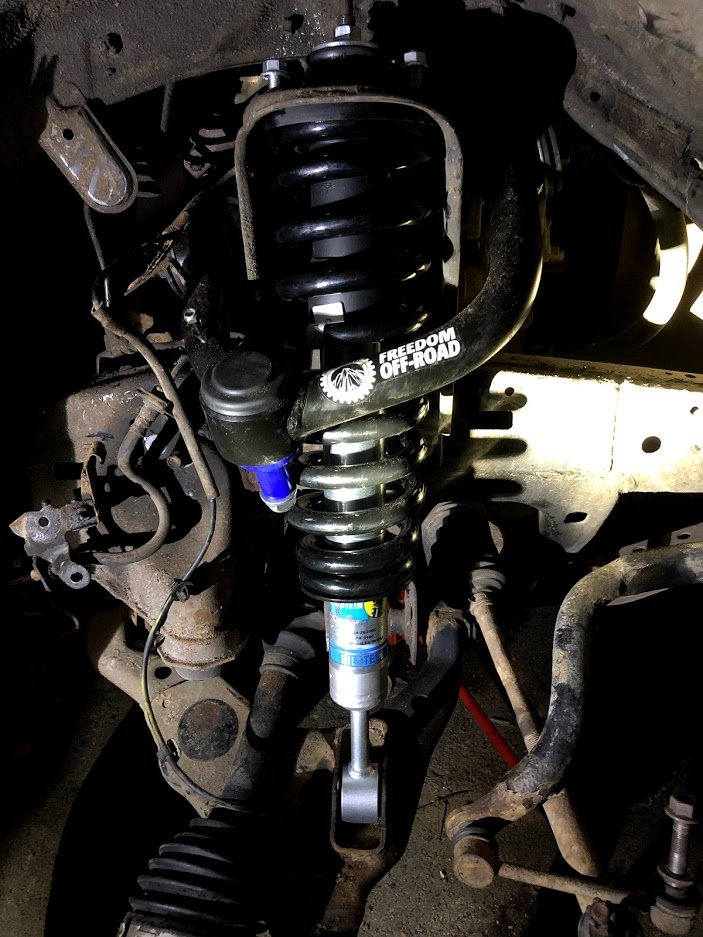

    I see what you mean,
    your coils are very spaced out.
    Here is my stuff before installing on the shocks

    are those 4runner springs?

    These almost look like rear springs. Are they possible mislabeled?

    I was also thinking they look like rears for a 4 runner.

    Those are rear coil springs

    According to the email I've just received from TDot, OME has confirmed that the part numbers on the springs that were sent to me ARE for my truck.. ffs.
    I don't know how that, when they see what I have compared to what it should look like, they can't see my issue.

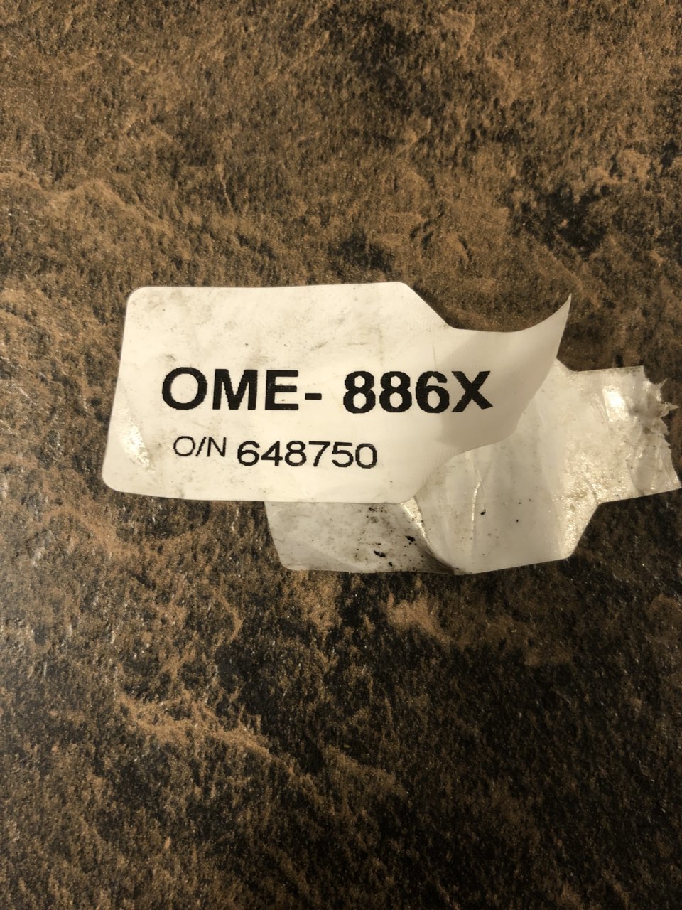

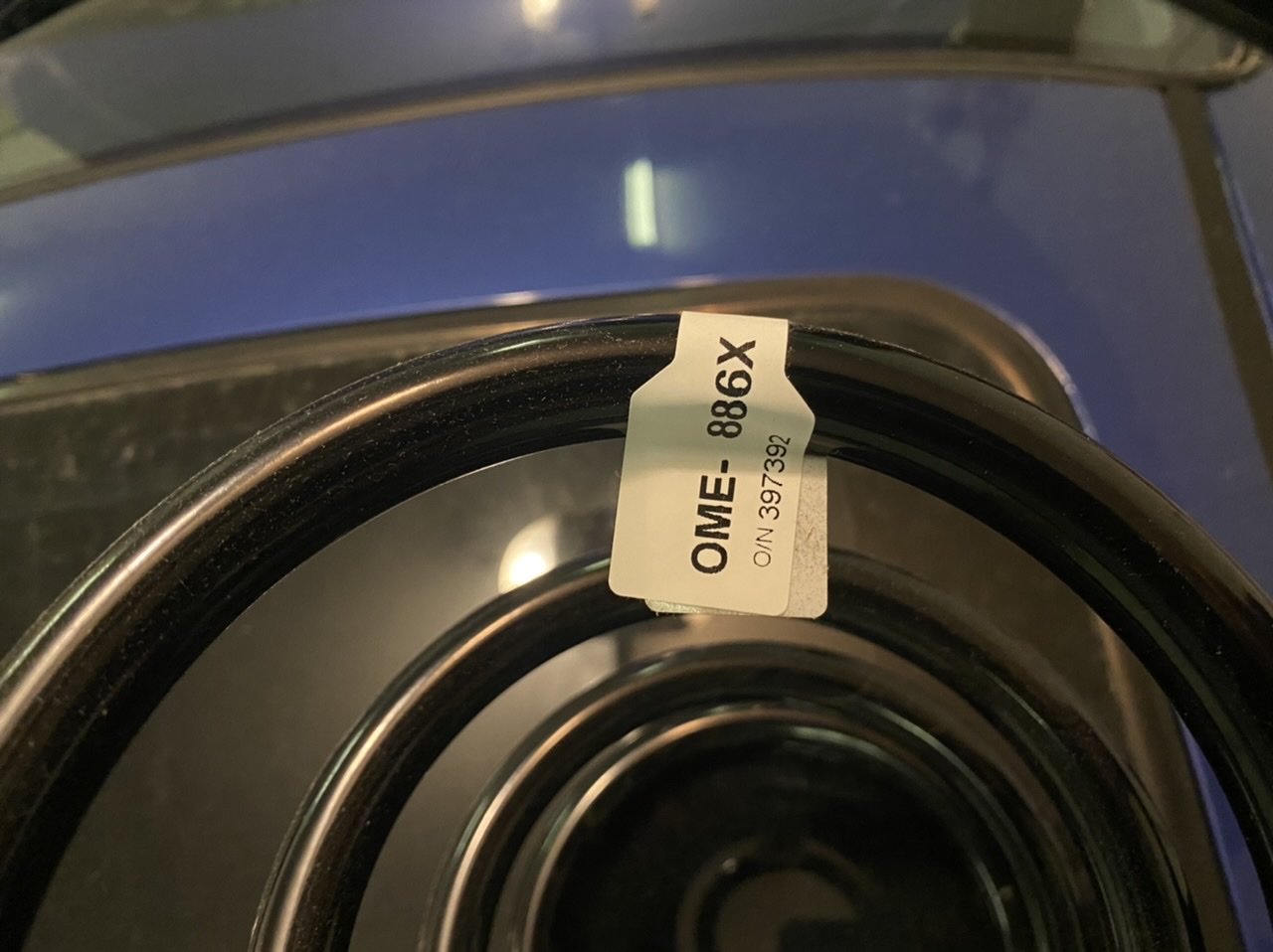

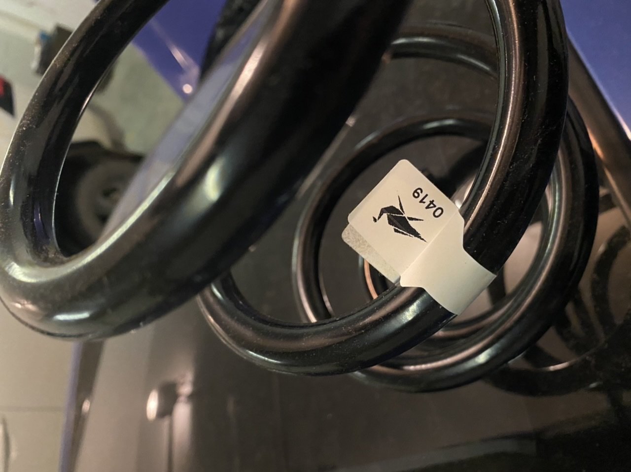

    If you can wait until tomorrow
    I bet i could get my sticker off my coil so we can compare

    Those are definitely rear coils they sent you. The front coils will have much tighter windings
    as well as be much tighter against the strut body. If you look at D2. pictures he posted you can get an idea of how close the coil will be to the strut. Here is another picture to show the size difference from the front to rear coils.
